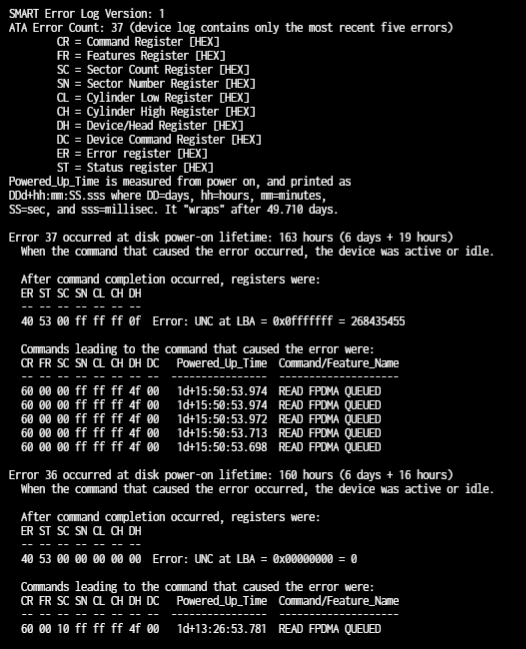

After we started moving files to the server and testing dockers, we got a POOL DEGRADED report. And the following statuses:
ZFS Health (X) RED ALERT
Pool Status: Unhealthy
30% Used Space
Disks with Errors 1

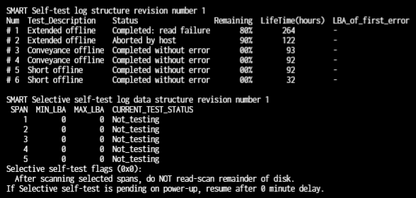

We performed our SMART Long test throught the Shell and after 1 week it finished stating COMPLETED: READ FAILURE.
We attached our log in this post and would like to ask the following question:
Should we send this disk to Seagate ASAP and replace it with another disk, or should we also be worried about other components?

You should send this disk back and replace it. This is a SMART failure.
