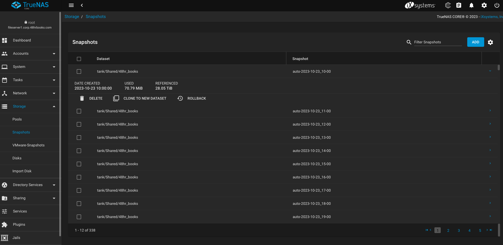

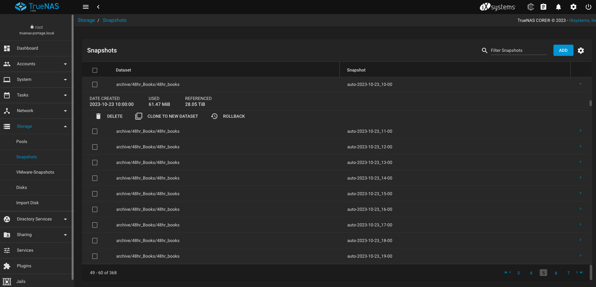

I took the destination server and pool do the location of the source dataset and started a new replication task Friday evening. Source dataset has been running hourly snapshot tasks for about 2 months now, set to keep last two weeks. Created a new PULL replication task on the destination server, setting it to keep all snapshots. First replication task ran without errors. So, I thought before I drove the destination server/pool/dataset back to my location, I would try a test - I created a new PULL replication task using the existing source dataset and existing dataset. I thought this test would replicate when I attach the destination pool/dataset to my production server at my location and then would need to create a new replication task to continue on with the on-site replication I started with the portable server/pool. But, I get the same error as I did when I tried the first time attempting to continue the nightly replication tasks after moving the destination dataset from the portable server to the production server:
"Destination dataset does not contain any snapshots that can be used as a basis for the incremental changes in the snapshots being sent. The snapshots in the destination dataset will be deleted and the replication will begin with a complete initial copy."
So, I'm either still missing some important step, and/or my test scenario of creating a new replication task using the existing source and destination datasets is flawed.
I've attached screenshots of my source server snapshots and destination server snapshots - ones that I feel match by date/time anyway. It looks like the size of the snapshots that are from the same date/time do not match though. I'm at a loss.
