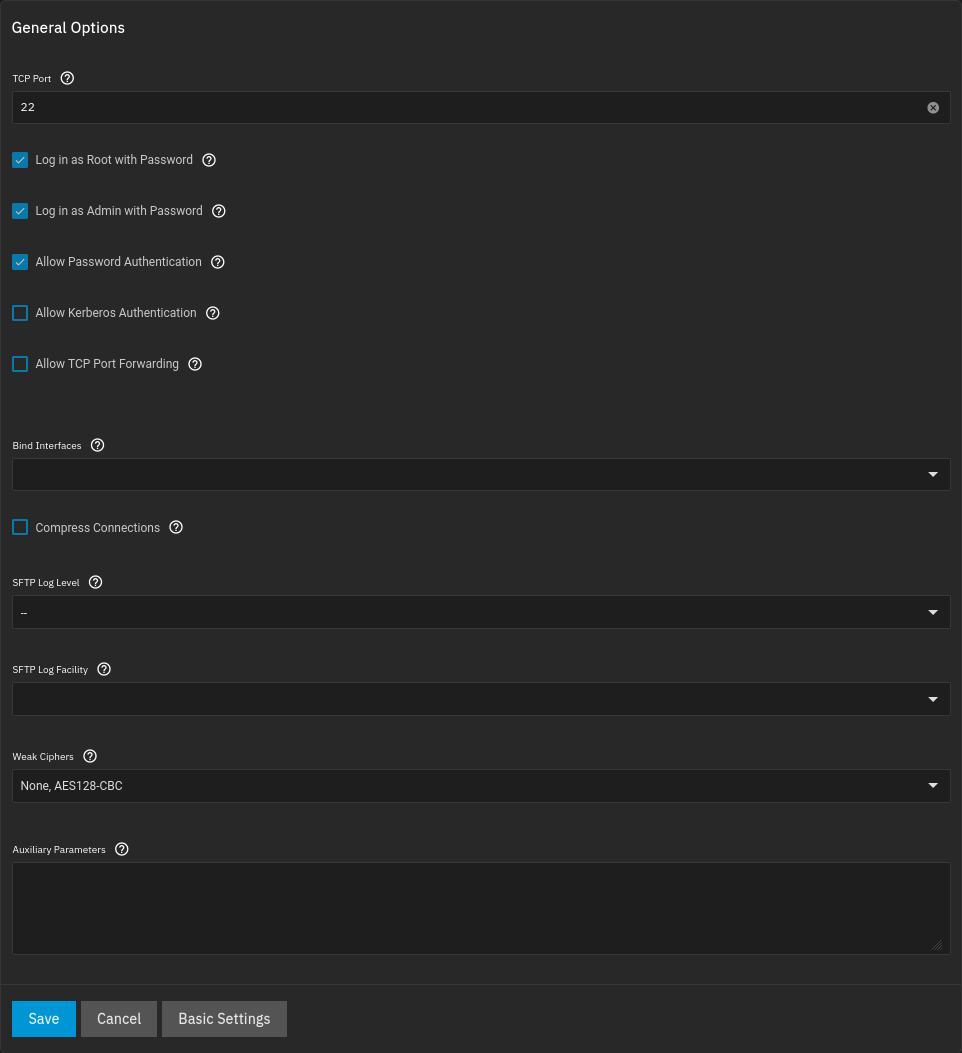

On my main server, SSH service is not enabled - on the backup (receiving) it is. That said, I experimentally tried turning on SSH on the main server, uncertain if that had been on earlier to make it work - nothing. Here is how both of them appear, configuration-wise:
The ZFS send is on an internal network and I prioritized speed, so I remember not setting encryption or anything of the sort for it. Not sure if something got reset on that front.

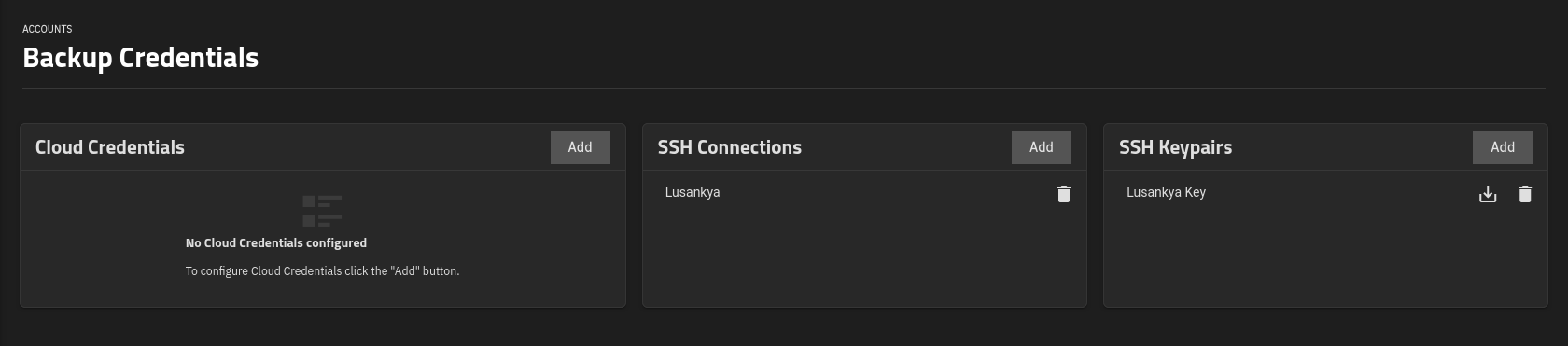

However, per this recommendation to investigate (thank you), I do see the following on my main server, but NOT on my backup server (all blanks for all three):
I don't know if it should also be appearing on my backup server, or if it ever did. It was a ZFS send replication (push).

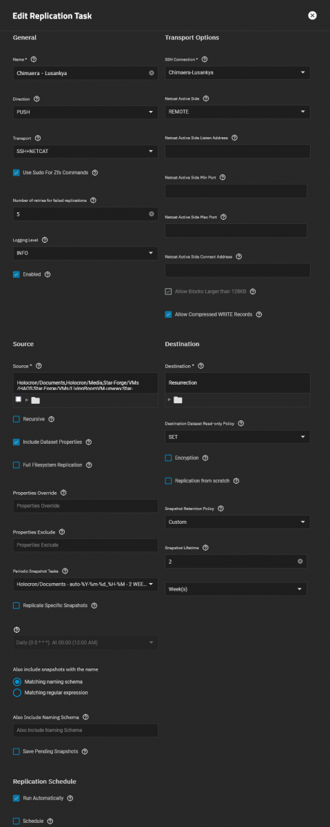

Here are the details of the replication task:

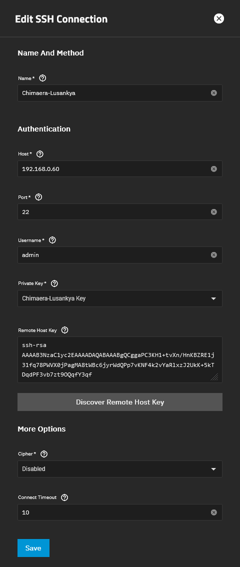

Here are the details of the SSH connection - still only has something on the main server (Chimaera), not on the backup server (Lusankya):

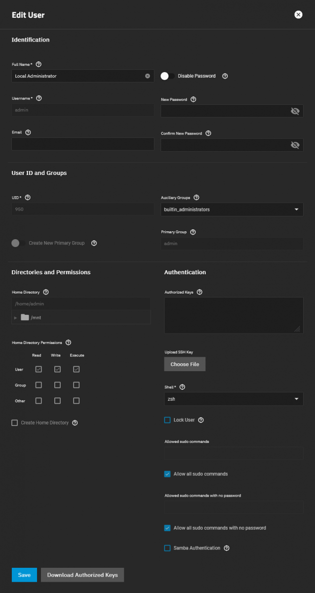

And here are the details of the admin account (on the main server):

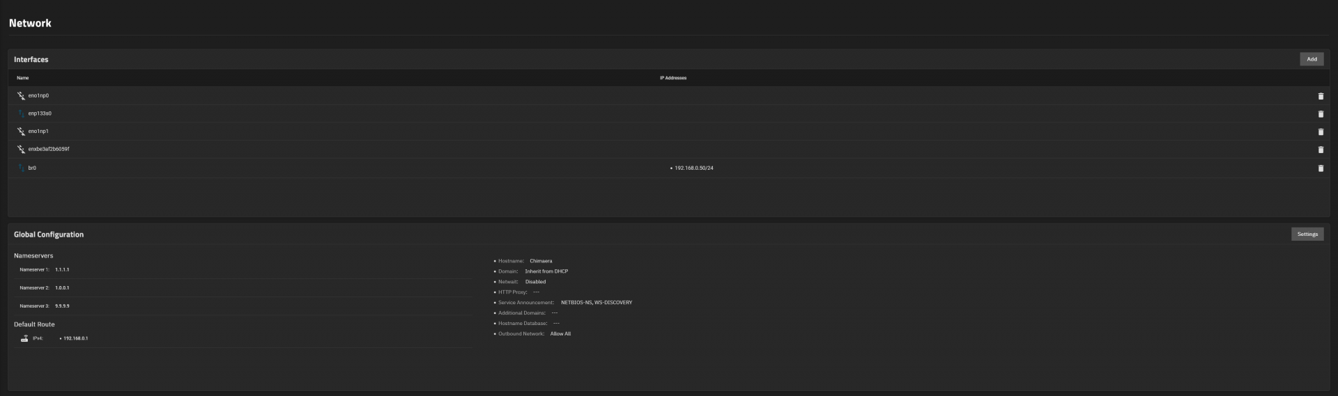

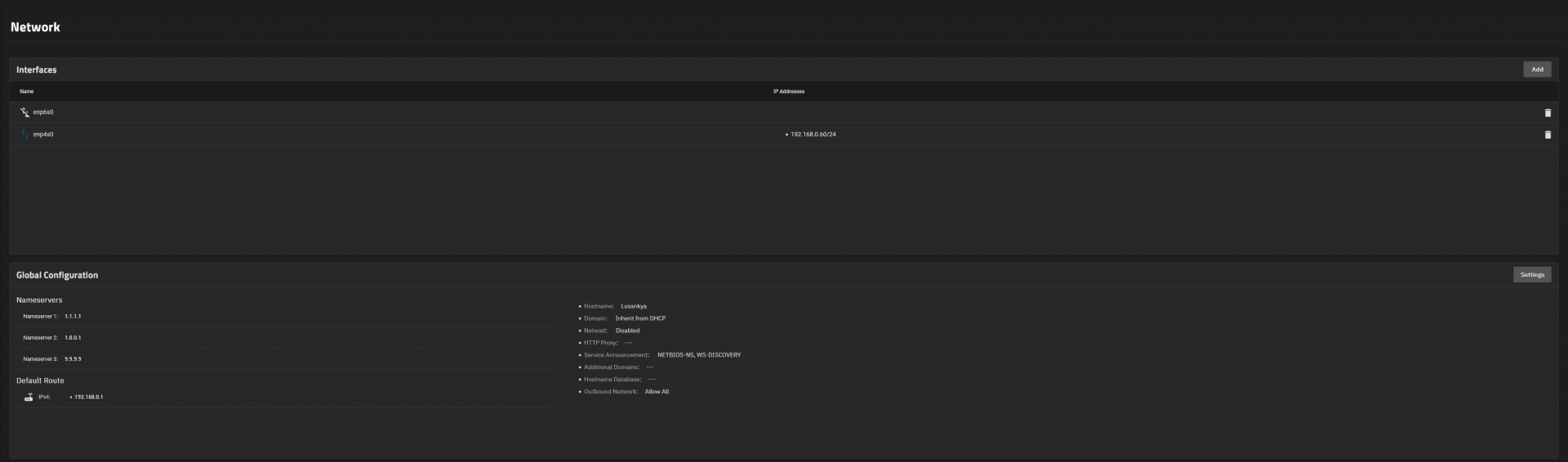

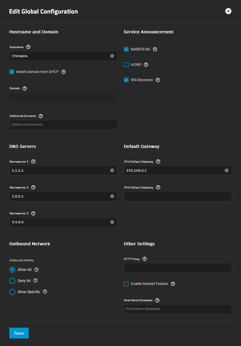

Oh, and here are the network configurations for both servers:
Really not sure what I'm doing wrong here. Maybe something leaps out to someone smarter than me?

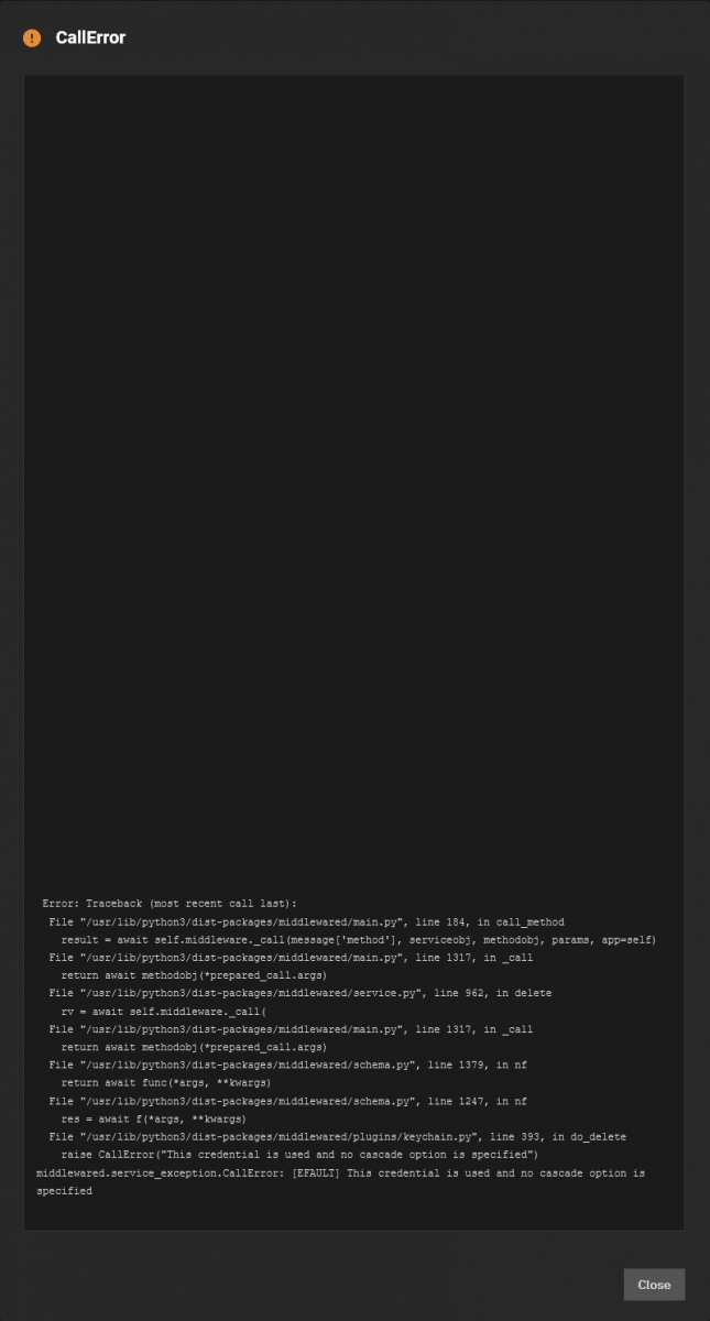

Well, updated both servers, was going to try one more bite at deleting the SSH keypair/connection and...this happens:
