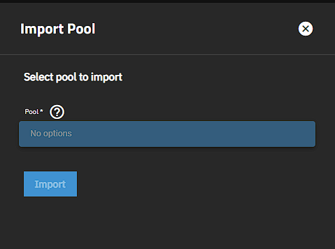

When I visit the GUI, the only thing I can find about the pool is it being showed as exported under Storage > Disks..
It is not available under storage > import pool although it's recognized in several places as being part of z2..

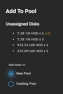

You are correct, my apologies. It was a Z2 VDEV spanning 4 total, with additional drives. The reason it wasn't a larger z3 is because at the time I created the pool, I only had 4x 8TB HDD, purchasing more later.. you know ... to avoid this.
I don't know how it was exported in the first place .. allegedly. However.. there is no option to import from the GUI, the pool drop down is blank, as pictured here:

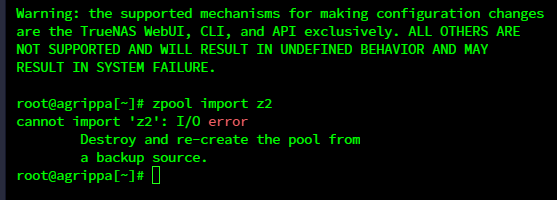

And when I use `zpool import z2` ... I get this beautiful message.
Well, that changes things and is not good. You might try to rollback a few transactions to see if that allows the pool to import, but it's a long shot.
Does the error pop up immediately or after a few moments?

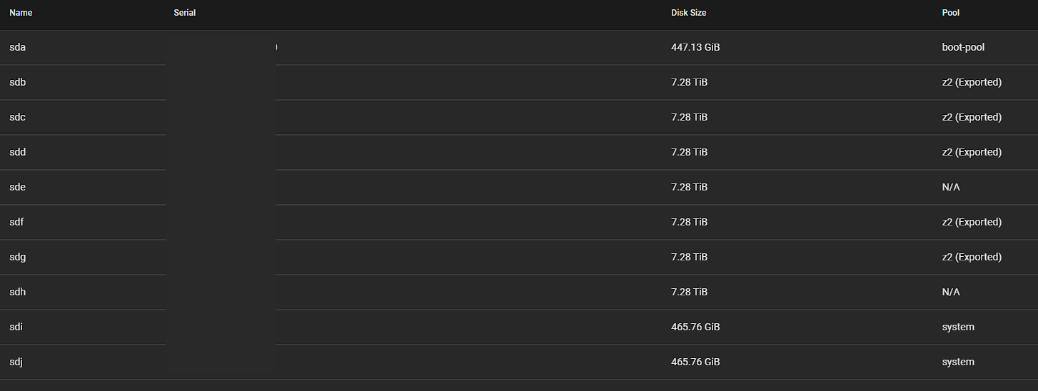

Little more information .. idk how helpful.. All the disks appear online everywhere..

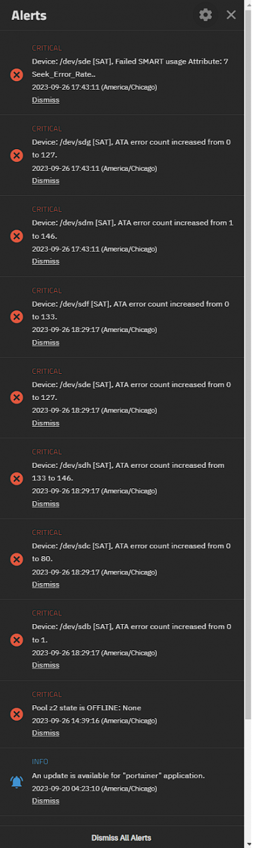

Model Family:     HGST Ultrastar He8
Device Model:     HGST HUH728080ALE604
Serial Number:    2EHEZYGX
LU WWN Device Id: 5 000cca 23bd47483
Firmware Version: A4ADWDA0
199 UDMA_CRC_Error_Count    0x000a   200   200   000    Old_age   Always       -       126

# 2  Short offline       Completed without error       00%     52626         -
sfatula
Jul 5, 2022
608
The reason I asked is in your OP, you said "after attempting to update my HPE server firmware". I'm not clear what attempting means, did it fail? It just seems like a big coincidence that you then suffer lots of various disk issues. Unlikely all the disks died at once. And usually UDMA_CRC_Error_Count is a cabling or other hardware issue. I'm more curious what you tried to do exactly and did you adjust any hardware during this process?
dgarner-cg
Sep 26, 2023
11
Okay, so .. the answer to that is basically no, and somewhat embarrassing, haha.
Earlier that morning I had received notifications on 3 drives at once, out of nowhere.. uhh. Okay, yeah, I anticipated it had to do something with seating of HDD, even though my other zfs pool is online, which is also in same JBOD...
I had been working with HP Enterprise on the phone for a specific issue related to an NVMe drive on a separate server, a DL380 Gen 10. During the phone call on that day, I was performing an upgrade to the DL380 SPP.. it completed successfully.
Onto our subject, once that was wrapped up, while still on the phone, talking through another issue .. I thought it a good idea to go ahead and upgrade the SPP of the DL360 while performing upgrades. I opened ILO, attach the SPP .ISO ... it loads, reboots .. and hangs, the HPE Tech and I are on screen share and after a few minutes I find it curious it's hanging on POST ... because the .ISO was on the D3600 JBOD. smhhh.
Reboot into not having zpool.
So it did not lose power mid-firmware upgrade, it was prior to firmware beginning. I have also taken the case off D3600 and reseated all easily accessible cables into the backplane twice.

Booted back into TrueNAS, same errors.. so uh.. I guess let's give this a shot, what's the worse that could happen, right? ...
dgarner-cg
Sep 26, 2023
11
root@agrippa[/var/log]# zpool import -F z2
cannot import 'z2': I/O error
        Destroy and re-create the pool from
        a backup source.
