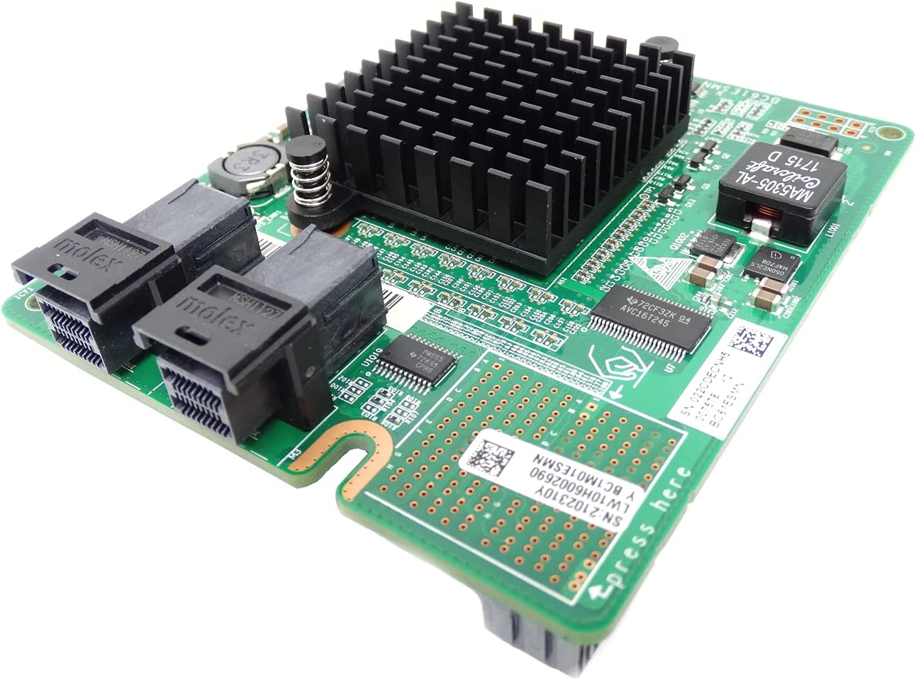

  • HDD RAID BC61ESMQ LSI SAS 3108 on a Mezzanine card.

the disk controller--I don't think that one can act as a true HBA.
Good point, I was reading 3008, not 3108. Looks like the MegaRAID version... no bueno.

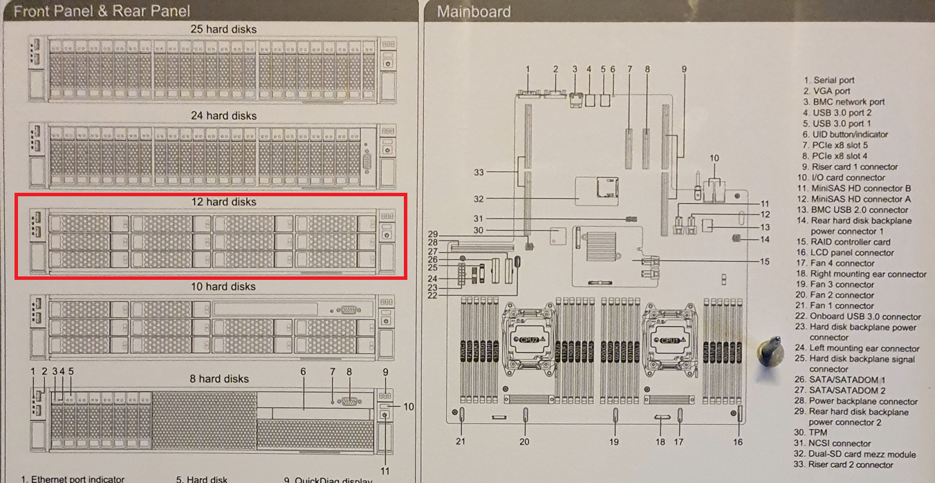

It seems from the video on replacing the RAID card that the backplane allows for connection via Mini-SAS connectors... it should just be a case of connecting the 2 Mini-SAS connectors from any HBA with those same connectors instead of the RAID card's.
Although I note that the position of the onboard RAID card may be quite different from the location of the PCIe slots, so the included cable may be far too short to reach it, hence requiring some annoying replacement/re-routing of a new pair of cables.

Ok, I checked. Cable length seems to be ok for a PCIE card in the rear, as opposed to a Mezzanine card in the midst.

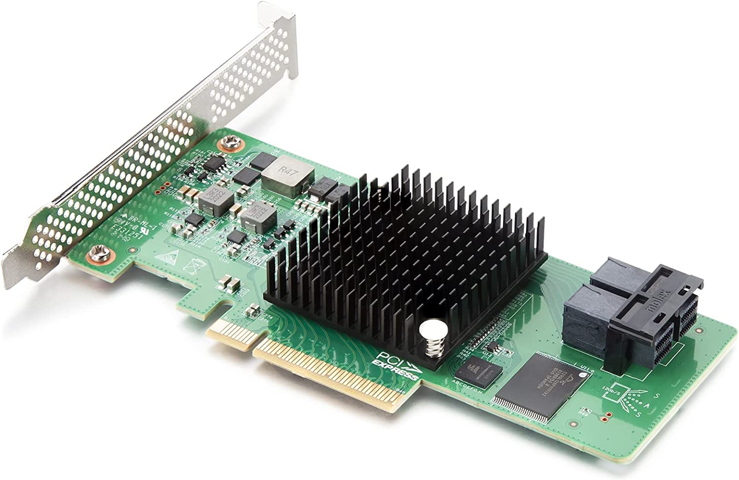

So I would be looking for a dual port HBA controller card than can handle up to 14 drives. I am assuming the descriptions saying 8 channels per port would allow for a total of 16 drives with two ports?
Like this:
That card is a Broadcom SAS 3008, this link https://www.amazon.com/Internal-Controller-Broadcoms-compatible-9300-8I/dp/B07VV91L61
Can you suggest any alternatives that may be a bit cheaper...
Maybe some like this: https://www.ebay.com/itm/1857440902...KliDglnwcY8kl/yhOZ9wkcQXY=|tkp:Bk9SR9islMC8YQ
9,700
For sure you can find many IBM or other third party cards carrying that LSI chip at cheaper prices, particularly 2nd hand online. (usually around €/$60)
The way those can sometimes work is 4 drives per connector (particularly when using breakout to SATA cables), but that isn't a limit of the connector or the chip (which can handle hundreds of drives).
It's up to the backplane and how it's set up.
It could be that it will allow only the 4 drives per cable (I guess in that case, getting to the 12 disks using 8 from the RAID card and 4 more from the onboard SATA (also using Mini SAS from the picture).
Without some experience with that backplane, it's hard to say how it's hooked up... maybe those 2 connections will cover all the disks.

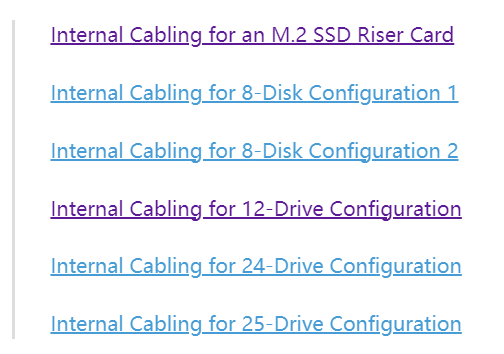

@sretalla as it is hooked up now with the 3108, all 12 drives are connected via those two cables so that is all in place.
The internal cabling instructions are extensive, but perhaps normal for this type of machine
I made a PDF from the latest official docs that cover this, so have a peek if you like :)

IBM HBA Card... would it be too much to ask for an example? A link?
Something like this:
or
will probably be easier for you as it already has the Mini SAS ports... going for a cheaper PCIe v2 card can save you around $50, but will mean you need different cables to go from the SFF ports to Mini SAS.
I don't/can't endorse either of the vendors specifically, the above examples are provided for information regarding the type of thing you're looking for only.
