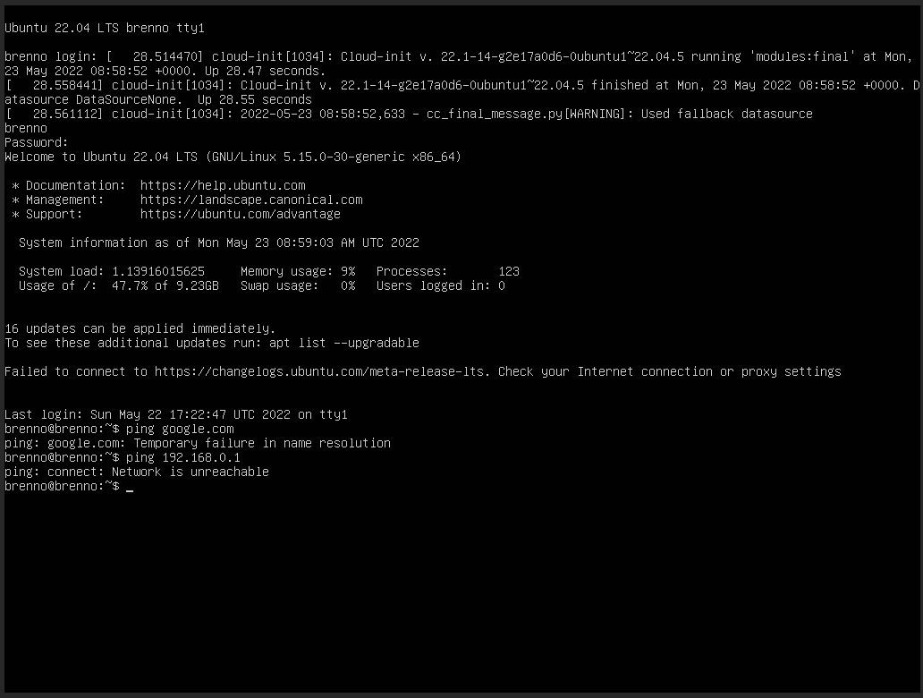

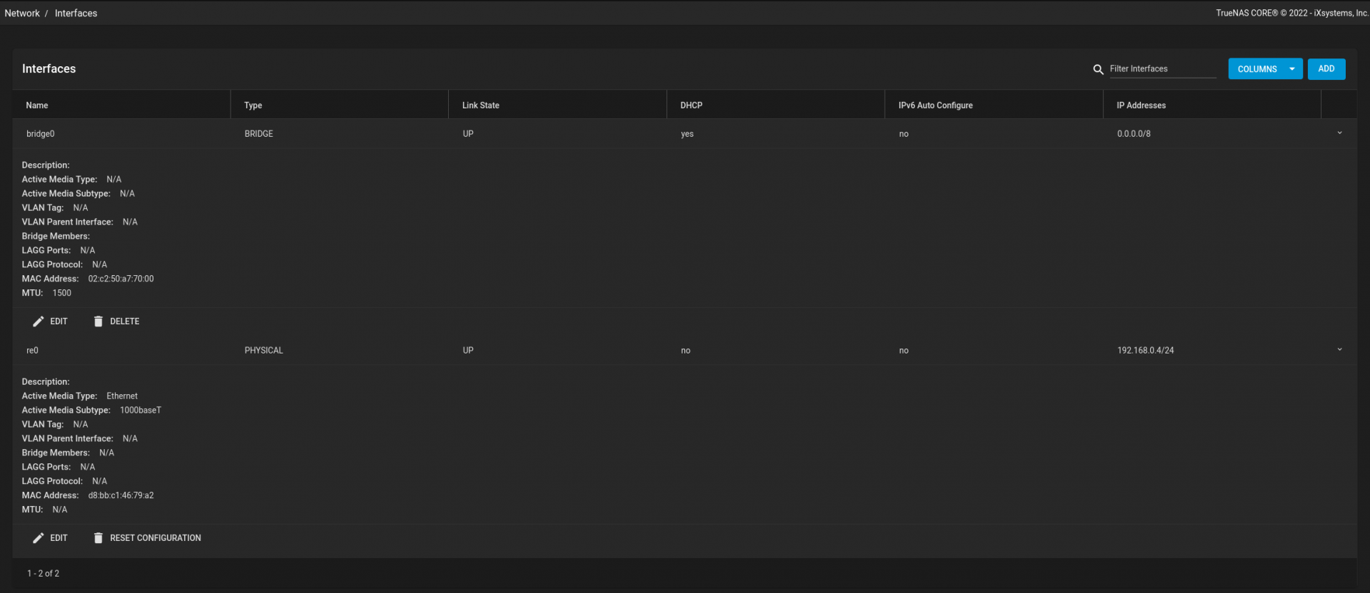

So, I've been researching this issue for many hours now without any conclusions. VM's created inside TrueNAS Core can't reach network. They can't ping the host, other private IP's in the network, or the internet.
I'm fairly new to TrueNAS, so I don't exactly know how to debug this. I tried to create a bridge network without success. Is there any guides or general tips on how to setup and debug this kind of issue?

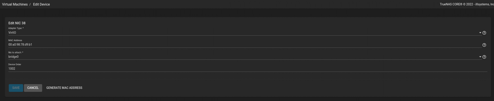

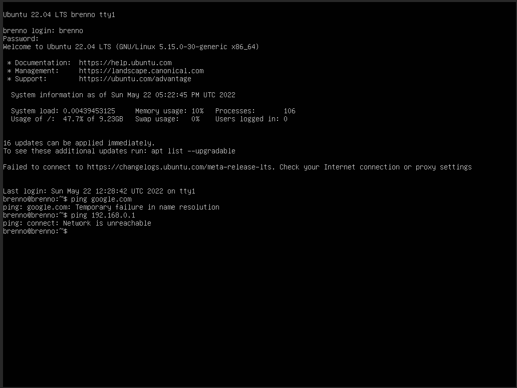

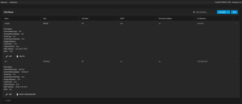

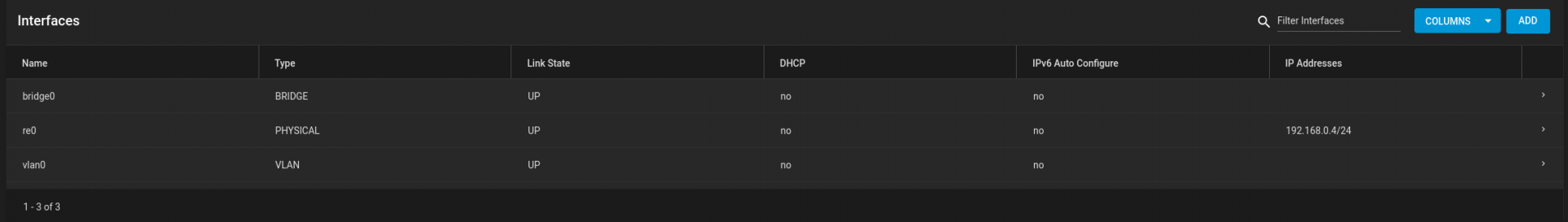

Hey, thanks for the responses. I haven't tried that because it was inside the Scale docs, so I assumed that will not be the correct one for my use case.
I've tried many Network configurations, combining Bridge, Physical and VLAN interfaces, and in none of them seems to work. Notice that TrueNAS itself and its services (Jails for example) can reach internet, its just the VM's that can't connect.
In the attachments I'm uploading my current configuration. As I said, FreeBSD is new to me (I've been working with Linux systems for many years now but first time with TrueNAS), and I could not find in the docs how the Network configuration should look like to allow networking in VM's.
Thanks!
