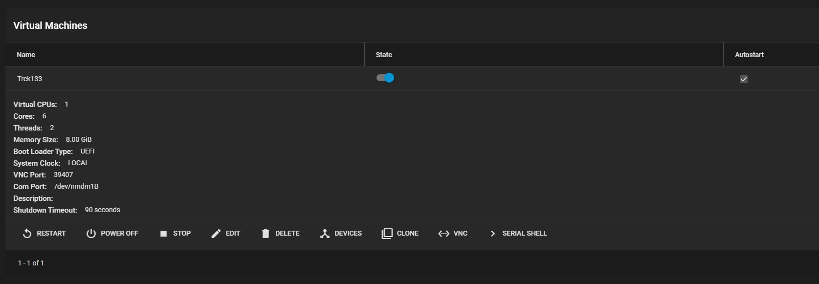

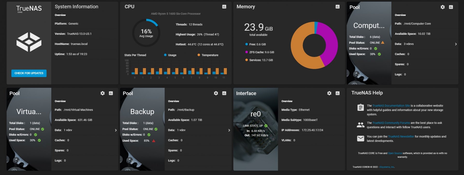

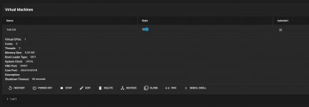

Here is my vm page ..
Only thing I can think of is maybe the whole system doesn't have enough ram ?

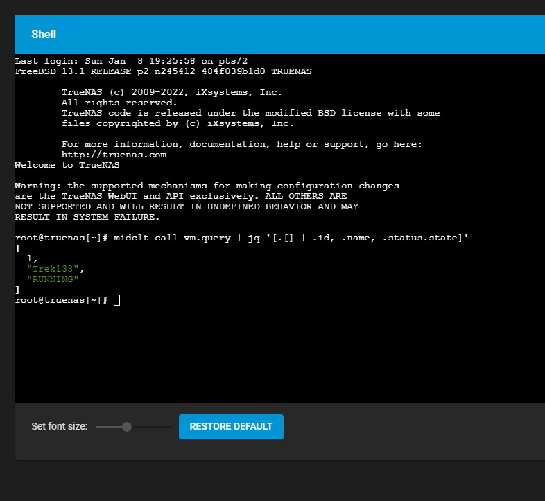

So Sretatta you mean something like this ..

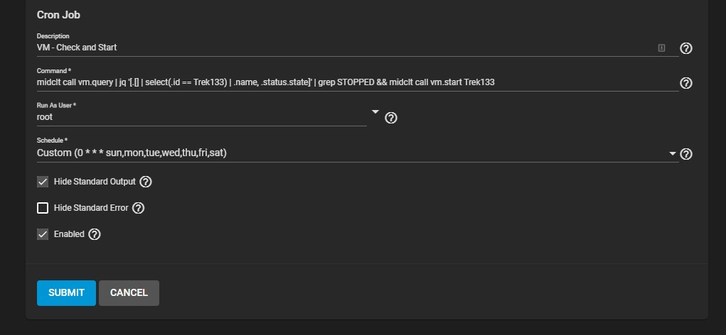

Well, not quite...
If you read my post you would see I recommend first running a query to see the ID of your VM... (won't be its name, but rather an integer).
You then use that integer (I gave the example of 18 in my post) in the last command to run the task.

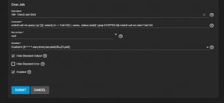

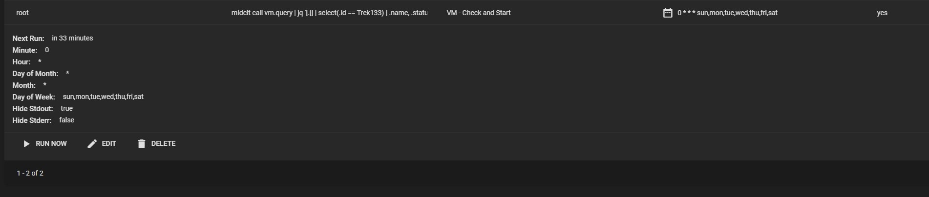

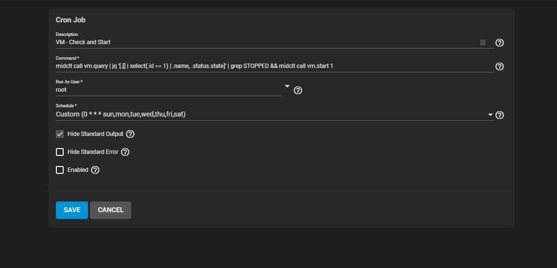

So something like this then ..

How much RAM do you have? I have this problem on both Proxmox and TrueNAS CORE back when I ran them on 16 GB machines. The issue stops completely once I upgraded to 32 GB.
If your VM's are shutting off on its own, you should actually attack the root cause of the problem that's making them do so and not trying to hack it through with watchdog kludge. Your VM's aren't supposed to do that.
Currently I have 24gb in it , but planning on upgrading to 64gb once I get the money to buy the kits ..

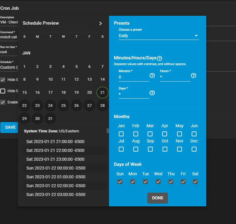

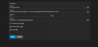

Hey Sretalla ..
I finally got to test it out and it works .. but I think my schedule is not correct .. I want it to run every hour ...
9,700
So you meant to select hourly at the top then? (instead of daily)
StarTrek133
Sep 5, 2022
112
Thanks Sretalla .. I got that done so should be all set and hope that when I get more Ram in the furture I can turn the job off and be good ..
