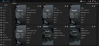

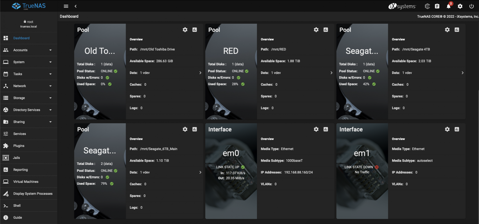

My issue is regarding the file transfer speed between the server and the rest of the computers within the network, first of all since I started to build the server I replaced all the switches in the home network with 1Gb and all the wires from and to all the devices with CAT6 and the server is connected directly with a CAT6 cable to a switch. The network adapter indicator light on the server is yellow which indicates that it has a 1Gb connection, but when I try to send files from and to the server I only get maximum of 17-23MiB/s. I will also provide a screenshot of the dashboard while I try to transfer a file to give more information. Could anyone enlighten me on how to increase my transfer speeds?

Try some basic debugging with iperf3 to help you isolate where the problem may be.

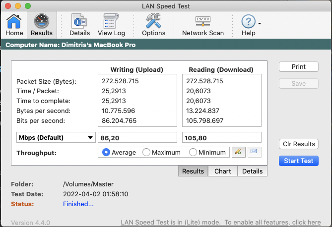

I see I did a quick test with another program that I have on my Mac and the results where far from the real speeds that I am getting, I will attach the screenshots on two of my drives. I have installed the iperf3 on the terminal app of Mac but I don't know how to install it on the server in order to make it listen so I can do the test. Do you know how to install it?
