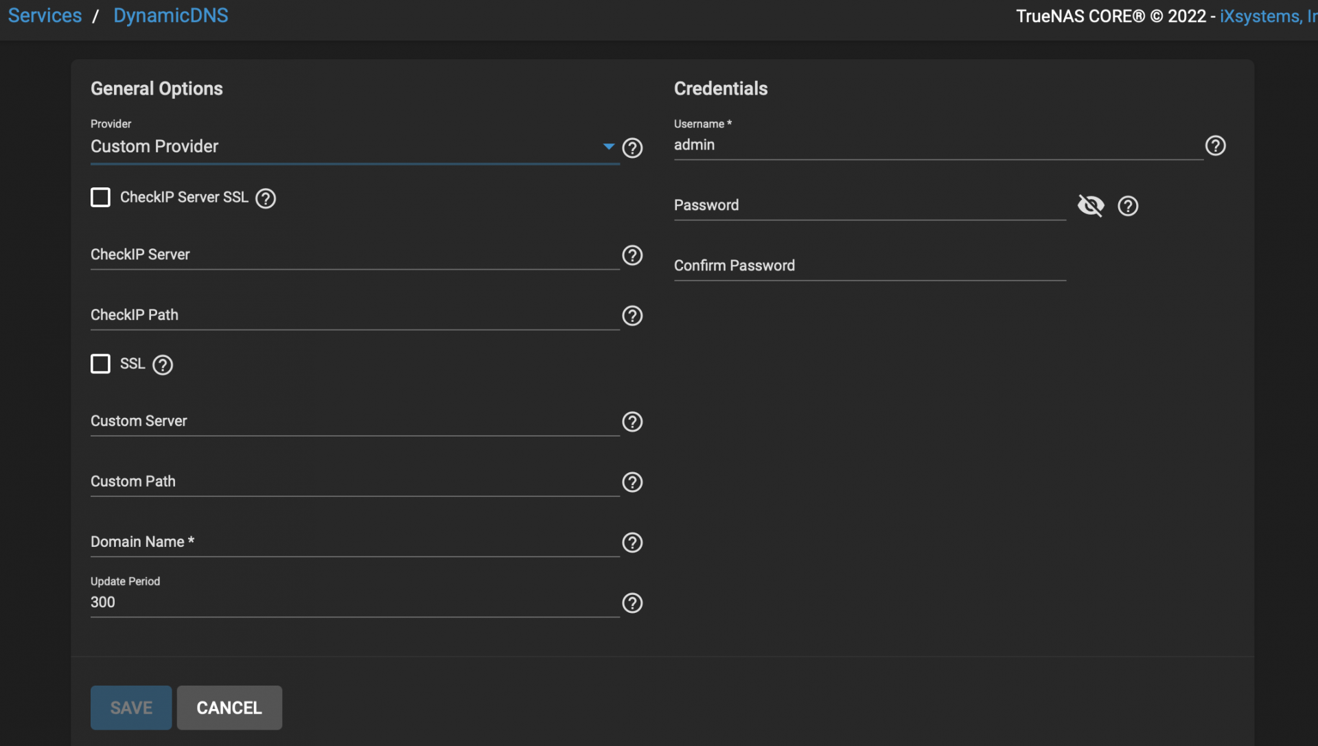

Jun 2, 2019
590
Is there a reason you can't simply use the built in DDNS service with a custom provider?
