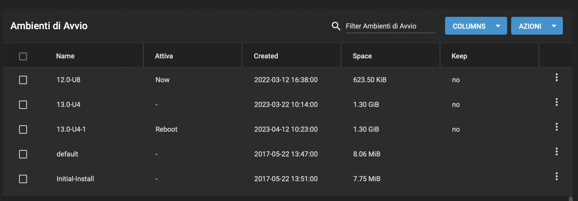

Willy666
Feb 10, 2017
28
Patrick M. Hausen
Nov 25, 2013
7,776
That's not a configuration backup but boot environments.
But did you set that tunable while running U4.1? Then you should be able to boot back into U4 ...
