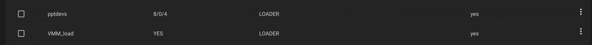

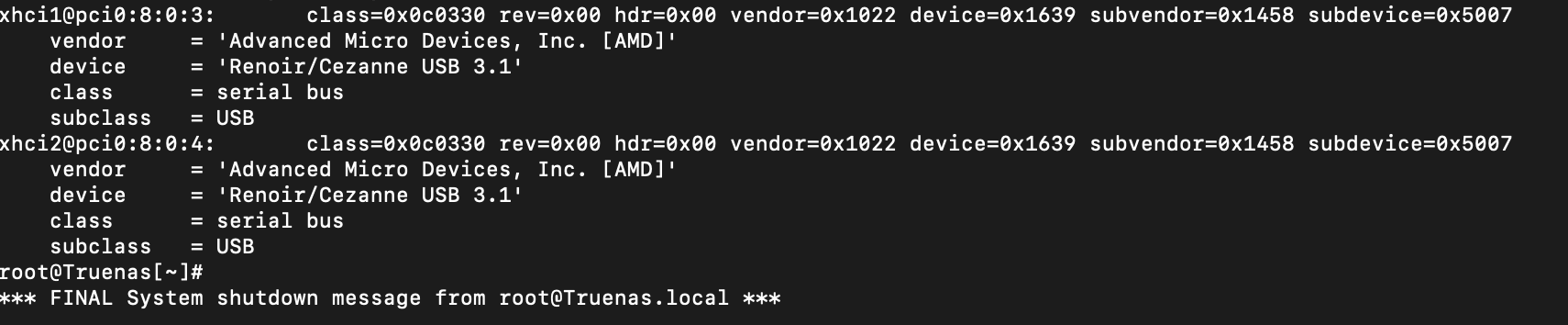

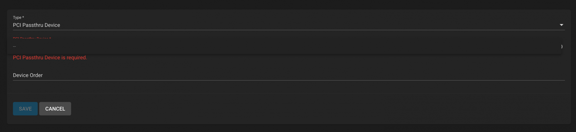

Hi I have a Truenas server at home running Truenas core 13.0
On the server is a VM running debian, witch is running a docker container with home assistant. I've purchased a Sonnoff Zigbee usb controller.
to use this I need to passthrough the USB controller so the debian OS can see the USB.
I've tried setting up the tunables but without luck. I can't sellect passthrough device, just an "-" is showing.
I've added pictues of the ssh where the usb controllers is showing, as well as the setting i've set in truenas.
can anybody see the mistake i Can't.

NugentS
Apr 16, 2020
2,947
I think you need to put another USB card into the server and pass that through to the VM, maybe
Sep 25, 2023
I have actually just figured it out. It was big letters in VMM. But a new issue acurred as I haven’t seen that the 4500 ryzen processor dosent support IOMMU
