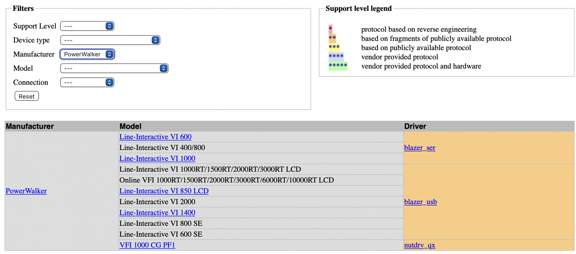

@jeti
According to the screen shot from his last post, he was able to communicate to the VI 750 R1U using the USBHID-UPS driver. Not sure if all the values were correct.
1. Did you leave the "Port or Hostname" set to auto?
2. Did you try the serial connection?
3. Have you tried direct messaging @Njanja?

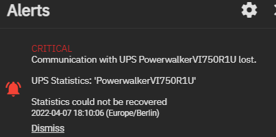

@elvisimprsntr
1. yes I did
2. just did, same result as every other Driver i tried
3. just did, but the user was last seen nov 2021, so my hopes are not high
as you show in your screenshot my UPS is not listed, my guess is that one manufacturer will not have a different drivers for each model, so I tried some other powerwalker drivers, all result in the same error...
jeti
Apr 7, 2022
9
Solved:
It works like it should, one need to stop the passthrough of your USB devices to your VM...
