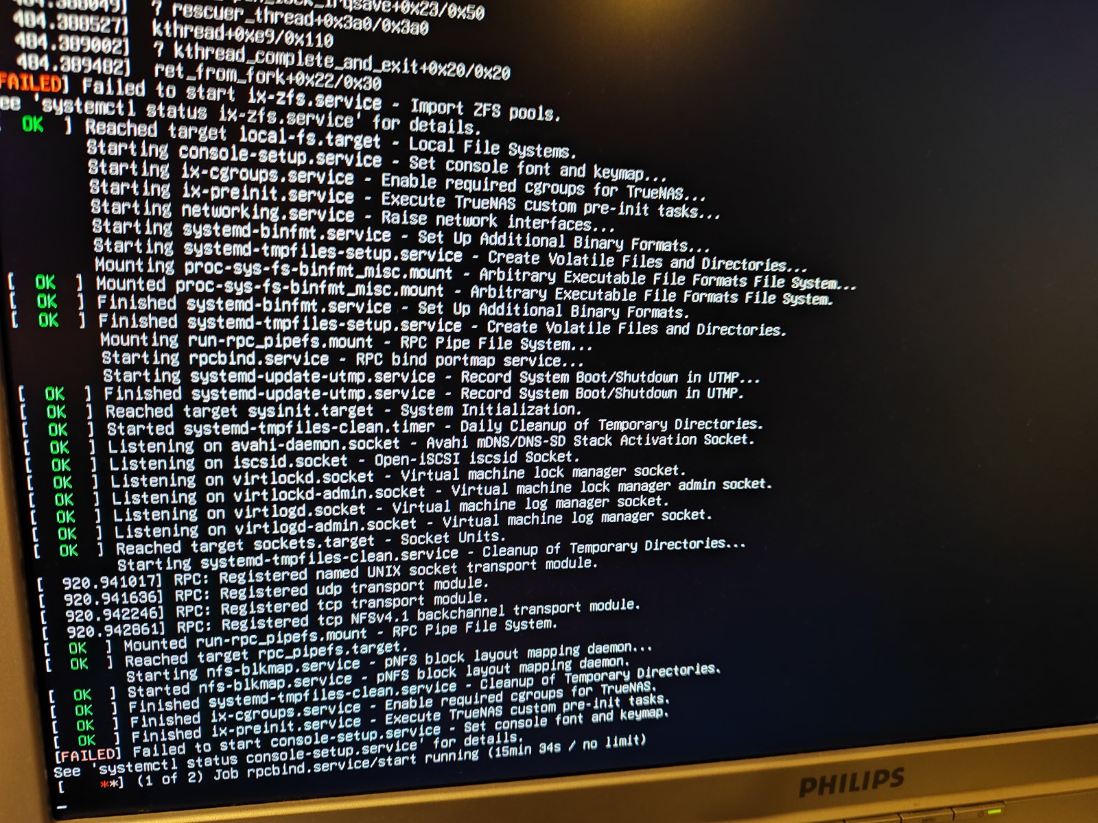

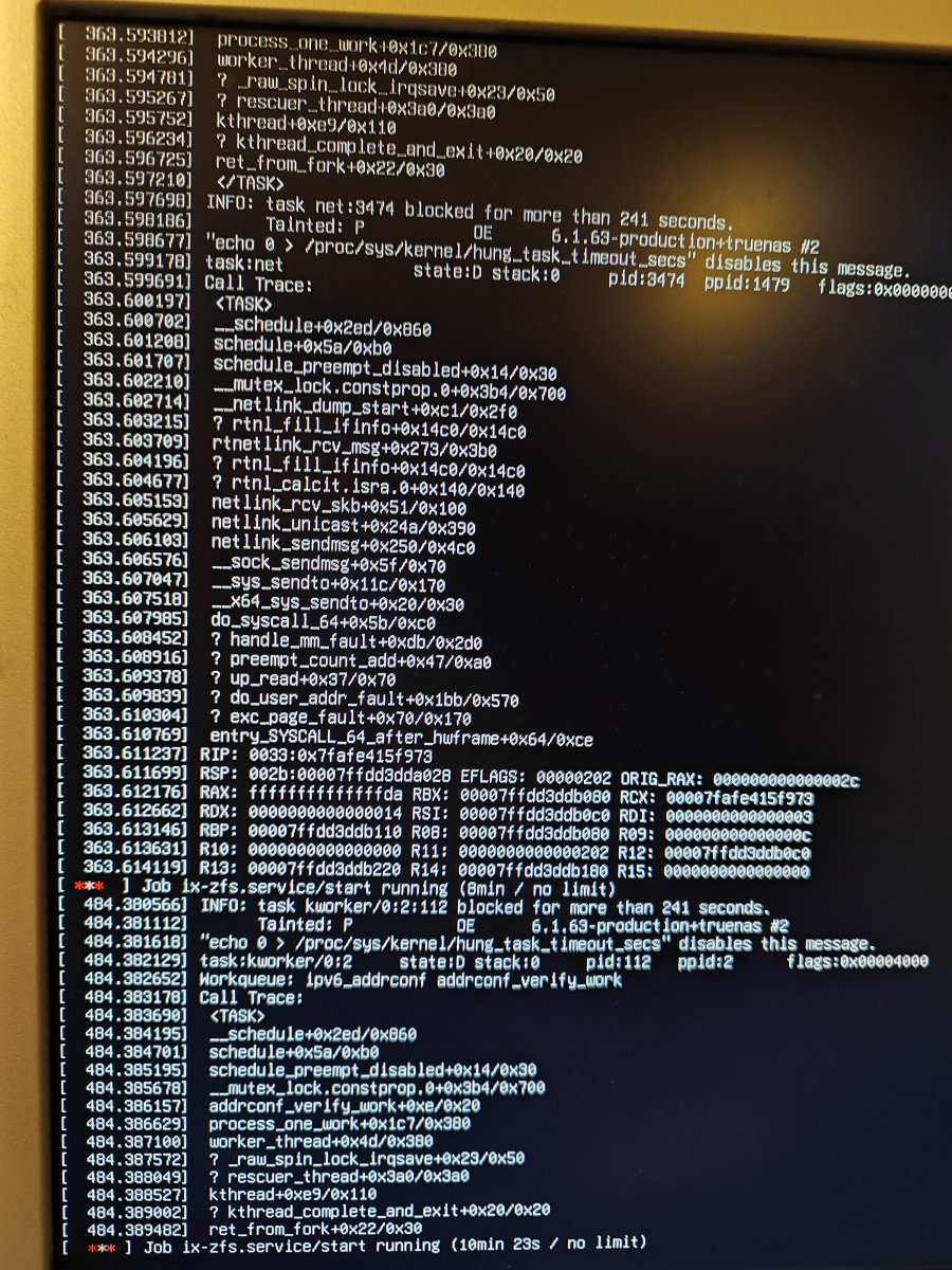

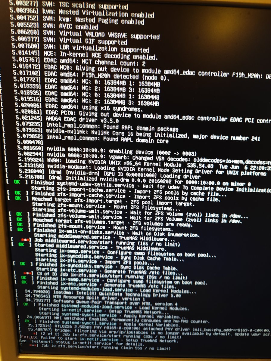

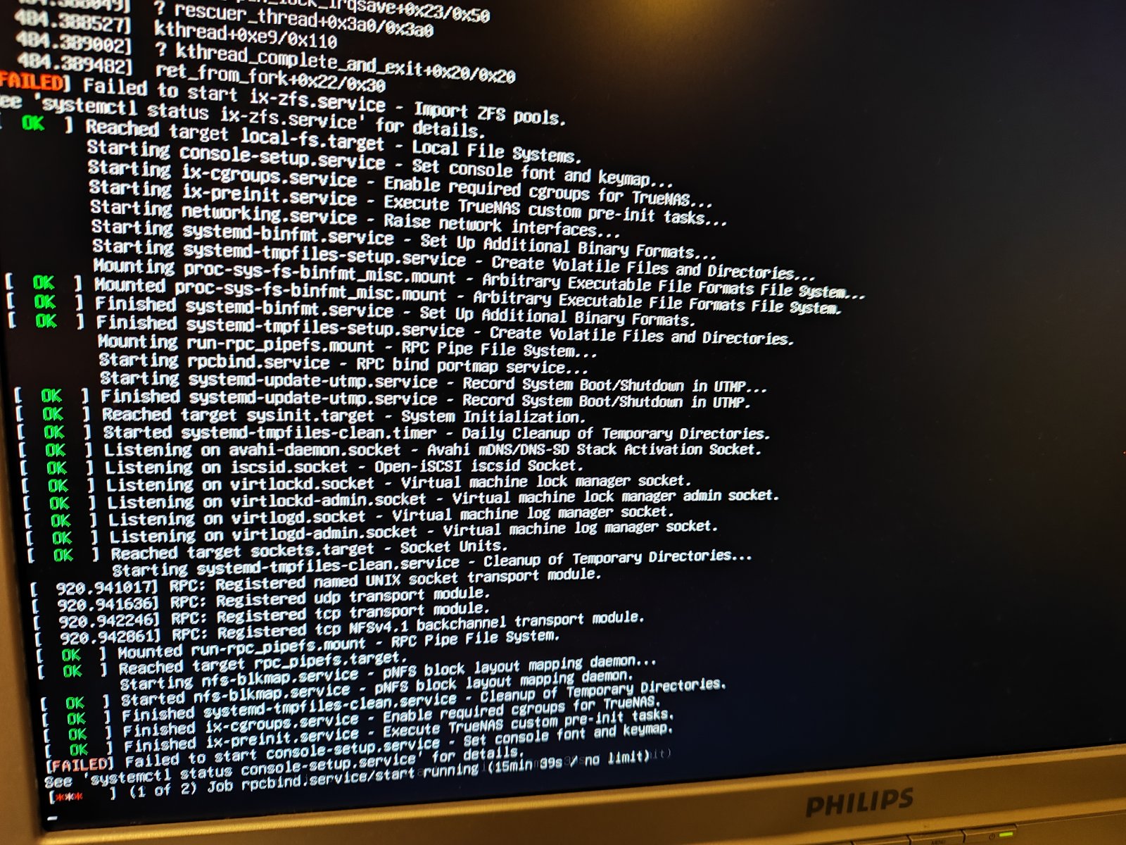

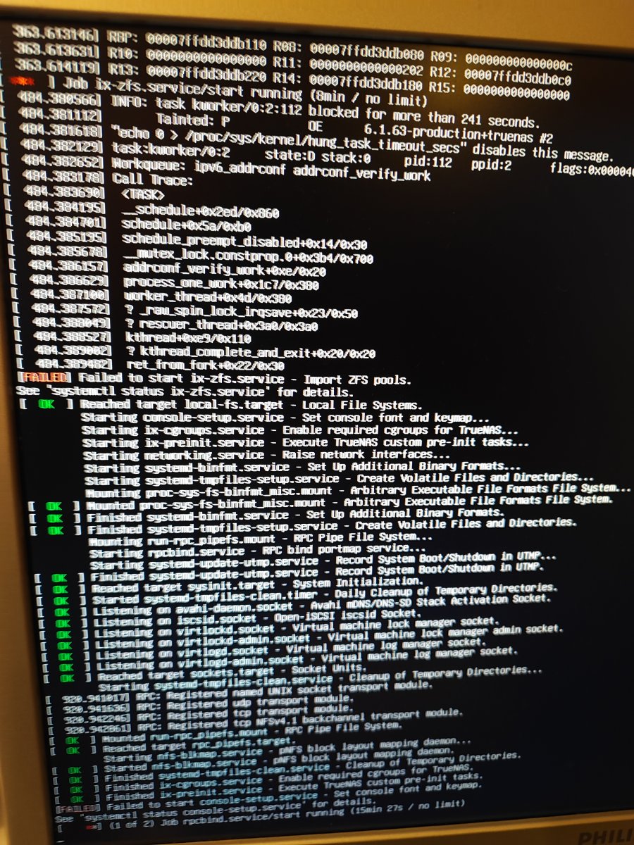

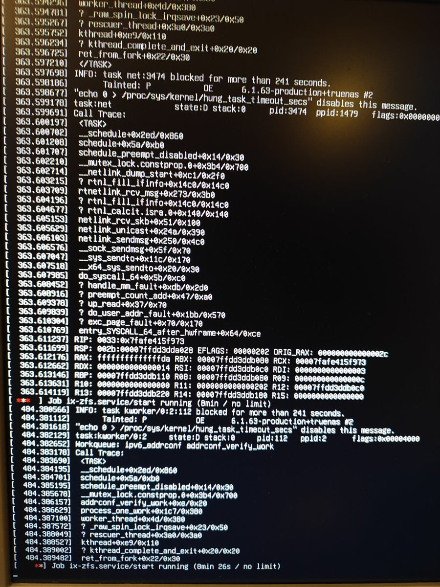

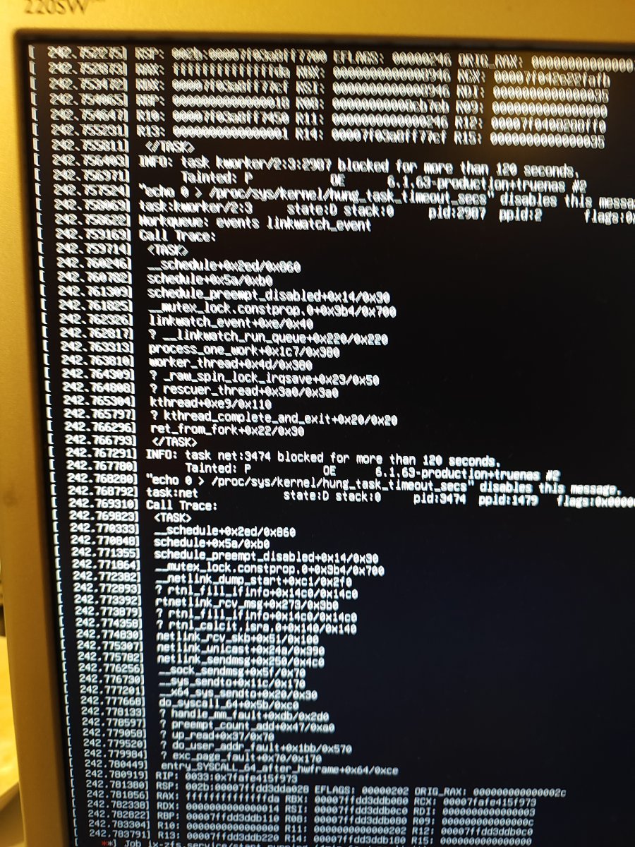

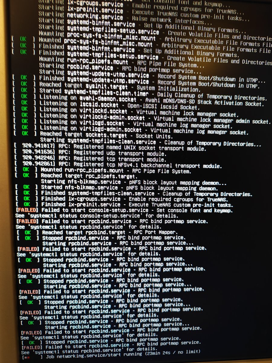

Hello,
i went from 22.12.4.2 to 23.10.1. I did the upgrabe with the GUI. After the reboot i got several failed services.
Failed to start ix-netif.service
Failed to start ix-zfs.service - Import ZFS pools
Failed to start console-setup.service - Set console font and keymap
Failed to start rpcbind.service
After a while i see the normal Console Setup. but if i tried to open the Network configuration nothing happen. But i can open the CLI.
I also tried to do a clean install of cobia and import my config afterwards but nothing changed.
There are screenshots attached to this Post.
Is it Possible to reset the network config bevor boot?
Maybe the start of the console-setup.service is due to my german Keyboard?
I also tried to boot in 22.12.4.2 but if i treid this i got an error message about the zfs version and unsuported feature. Is it Possible to import my zfs pools back to Bluefin?

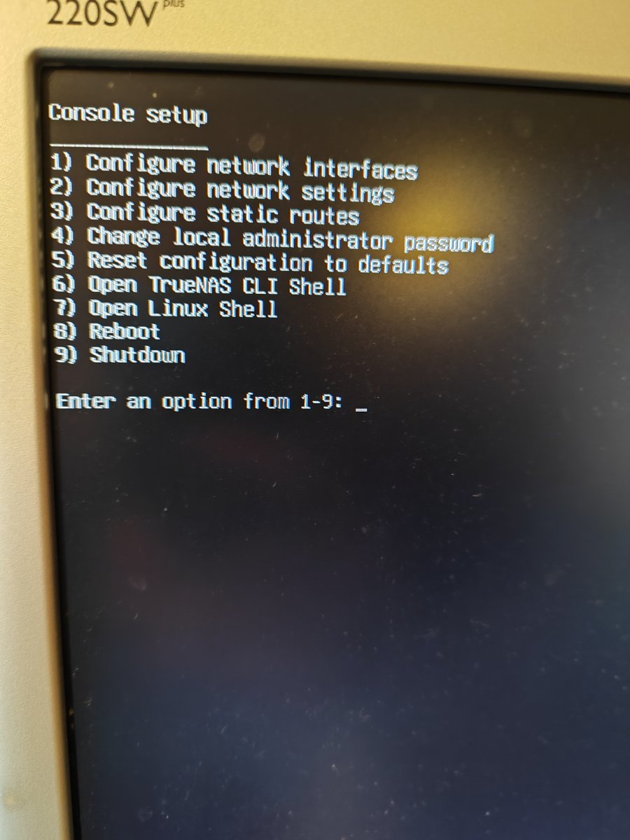

Sorry that was my mistake. No i have no GUI acces on My Cobia system.
What i descripted was only a test system with bluefin.
The Config file i generated bevor the upgrade.
With Cobia i mean my System with my data and evrything. With this Cobia System i see in the Linux shell that my zfs pools are mountet and accessible. After this system boot up i can only access option 6 and 7.
So that means zfs and the pools seems to be working fine. But i can not access the GUI.
cplatte
Jan 24, 2023
5
Thats what i see after boot. But everything i tried to open except option 6 and 7 doenst work. I also tried to connect different network Cards.

I found the Problem. As i mention bevor the problem was the bridge network configuration. To solve this i deactivated all onboard network cards in the BIOS an discconected all other NICs. Then the system bootup normal. Now in the console menu it was finally possible to delete my bridge config.
Bevor all of that i tried also to delete this bridge interface with the truenas cli. but this was not possible. It run evrytime in a timeout.
Now everything works fine! Thank you for your help.
It seems to be that this behavior is a bug with the config file. Because even then i tried to upload my config file (that was generated also with bluefin same version) to Bluefin it doesnt work.
