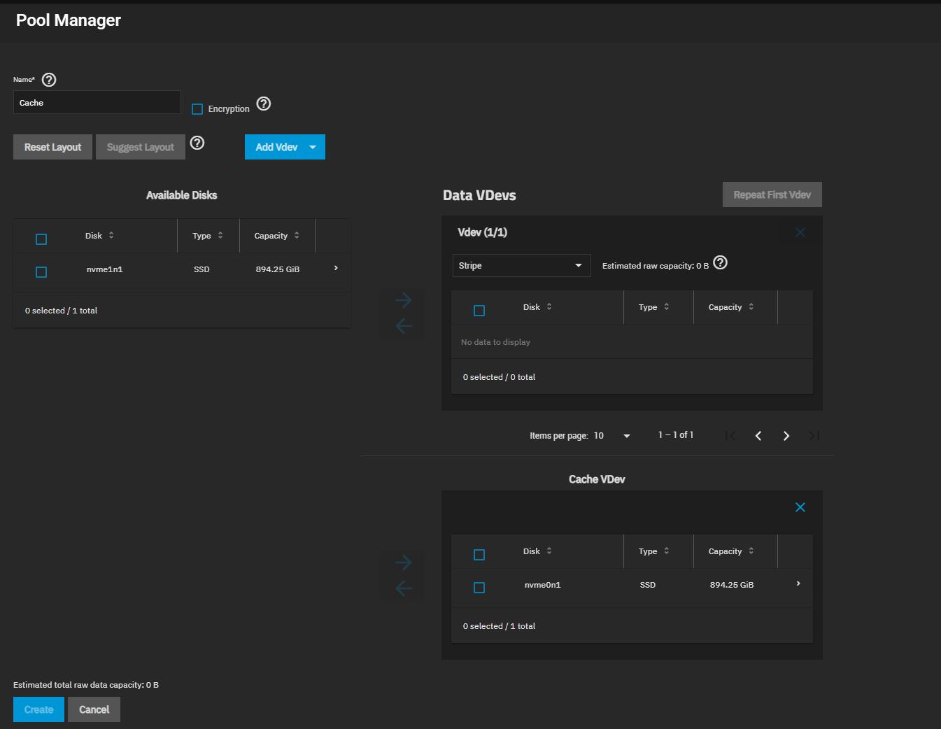

I would also like to assign the second NVME as a single device pool for apps/VMs. Is this possible?
TIA
Oct 22, 2019
3,641
You're trying to create a pool named "Cache", without adding any required data vdevs...?

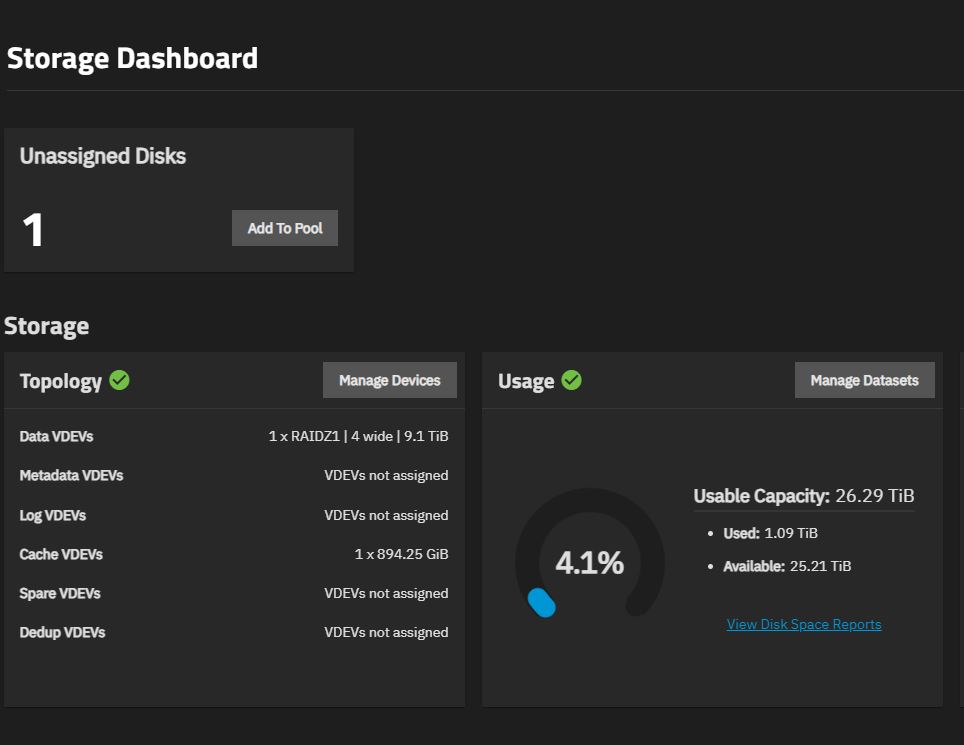

Hello,
Sorry if my mentioned config was not clear before. I am running Truenas Scale bare metal. I initially assumed having 256GB of memory was adequate for caching but decided to add a 960GB NVME as a cache drive. The second 960GB NVME I will use for apps/VMs. Please let me know if my configuration is not optimal. Just did a file transfer and didn't seem to utilize the NVME cache drive.
Lenovo P720
256GB
2 x 256GB NVME RAID1 boot
4 x 10TB RAIDz (1 x 960GB cache)
1 x 960GB NVME Apps/VMs
I don't plan on running much VMs on this machine, maybe later. Main use will be network storage.
That gives you 128GB of ARC. At that size, you're fine. The concern was that you can be sabotaging yourself. The ARC works by keeping track of statistics such as "Most Frequently Used" and "Most Recently Used". If you had, for example, just 100 megabytes of ARC, which could be only enough ARC space to hold very few blocks of data, the mere act of accessing a moderately full directory would be likely to overrun the ARC with read requests for all the metadata blocks. These would then immediately get knocked out when you tried to access a file in there, and then when you accessed another directory, THOSE would then get quickly knocked out too. This is referred to as thrashing. The MFU/MRU mechanism REQUIRES that blocks stick around for awhile so that ZFS can observe which ones gain multiple access requests. If that fails to happen, ZFS cannot make good decisions about which ones to shove out to the L2ARC SSD, and essentially pushes random crap out instead.
The goal is ideally to cache blocks (such as directories you frequently visit) and hold that in ARC. So you might have some blocks that you've accessed 50 times, others you've only accessed 10 times, some that have only been accessed 2-5 times, and then the ones that have been accessed only once. The ones we want to be evicted to L2ARC are the ones that have only been accessed 2-5 times. The 50x and 10x ones are really doing something significant for you. The ones that have only been accessed once are doing nothing for you. See how that works?

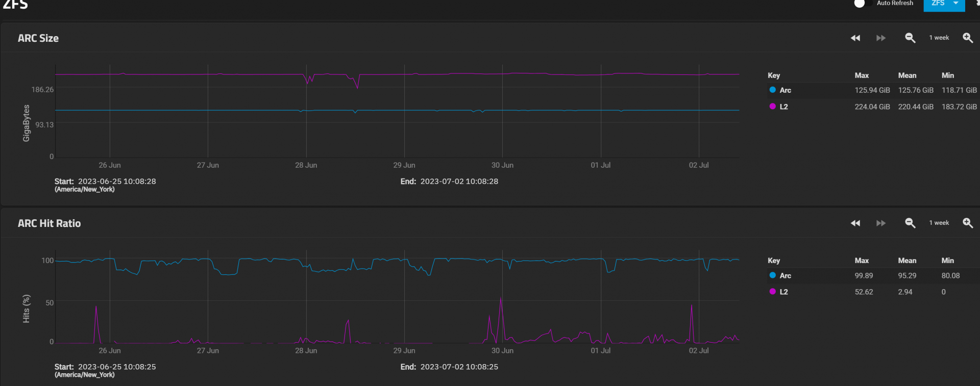

YMMV when it comes to the usefulness of an L2ARC. I have 128 gigs of arc, and 224 gigs of L2ARC, and with my workload the mean L2ARC hit ratio is only about 3%. My workload just doesn't benefit from having it.

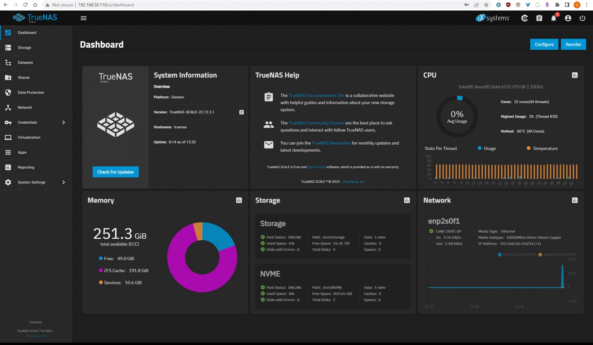

I deleted my storage. Recreated a RAIDZ2 with 4 HDDs no cache, RAID1 with 2 x 960GB NVME for VM/Apps. I entered min/max arc commands in the init/script. Speeds have increased a little but not what I had hoped. I do get bursts of 550-600MB/s but still mainly at around 300MB/s which is close to my HDD speeds. I opted out of setting the block size to 1M going with 512kb instead, not sure how much of an impact that has.
I'm not going to bother installing more ram. L2ARC is something I can consider adding in the future.
