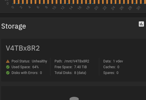

2 Checksum errors on all of the drives after a resilver and replace >
My SMB shares are working, but on the dashboard, Pool Status shows 'degraded', yet all drives show 'Online'

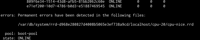

errors: Permanent errors have been detected in the following files: V4TBx8R2/.system/rrd-d968e280827d4008b5065e3ef738a9cd:<0x3eb>

9,700
errors: 1 data errors, use '-v' for a list
I would highlight this as the answer to the pool's degraded state.
zpool status -v
to find out which file is impacted and think about how to handle that.

You have almost helped me to a solution, but how do I resolve it ?
The file seems innocuous and deletable, but I am stumped as to how to clear the error on the Truenas Dashboard.
Do I simply rm the offending file ?

9,700
You can try that, but it's part of the system dataset, so you may need to move that to another pool (boot pool if that's all you have) and then back again.
