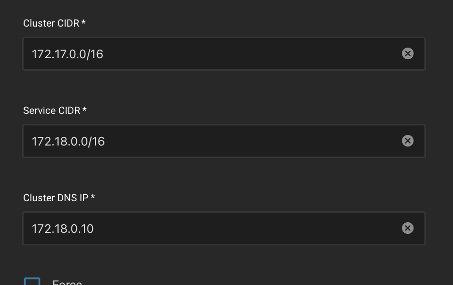

is there a way to tell the K8 / container environment to live on something else.
Of course there is. Apps -> Settings -> Advanced Settings. You can change cluster CIDR, Service CIDR, and the DNS IP there. But apparently that will result in loss of all your apps and data, so you'll need to reinstall them.

I can't afford to change the K8s environment, 172.17.0.0 s as you said that all nuke my apps and well thats not a option.
trying to figure out how metallb-config that accepts my 172.16.10.10-172.16.10.100 and well the cluster seems to sit on 172.17.0.0
some how need to get metallb to start up/run and listen on 172.16.10.0 and route to 172.18.0.0

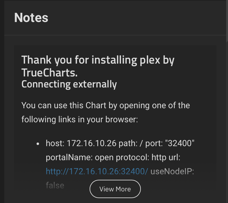

plex seems to be running and it's saying it's listening on the desired address.
but some how it's not being routed into/onto it.
