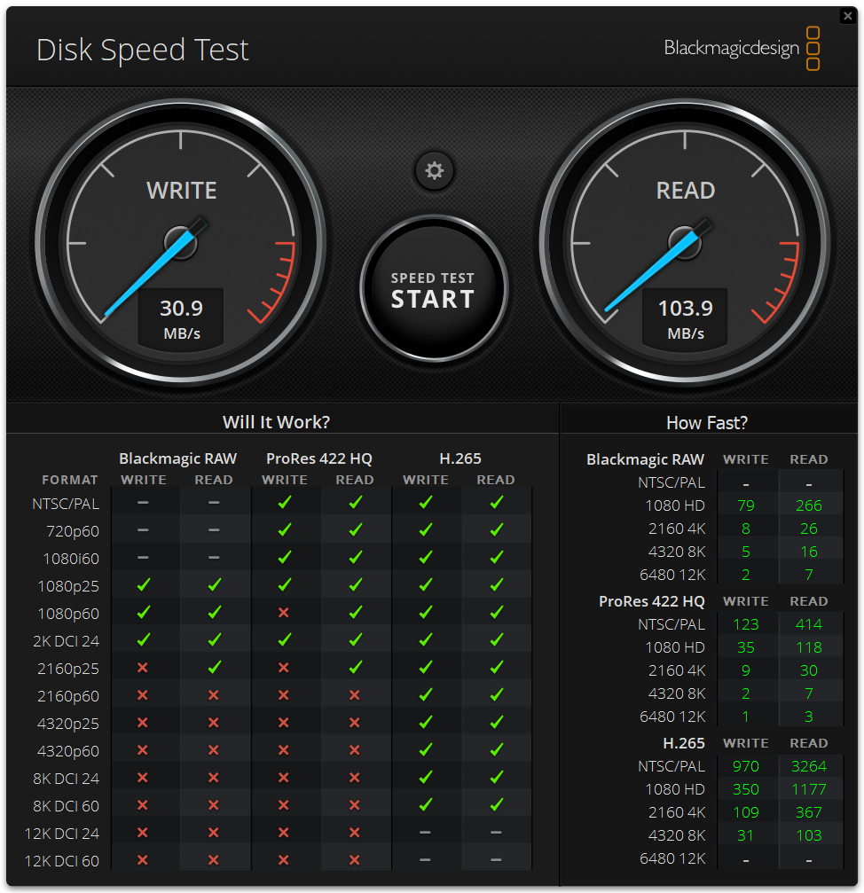

Latest SCALE working very good.
But maybe there are some improvements to be done on SMB write speed, as mentioned by many others.
With Syncthing I get transfer rate from pc to TrueNAS SCALE averaging writing 100 MB/s and even peaking at 110-120 MB/s on my 1Gb network (this was a 1.4 TB folder transfer/sync). So Syncthing appears to maxing out the network limit vs TrueNAS SCALE.
But with Black Magic Speed Test only 30 MB/s write speed - using SMB network drive.
Read speed seems very good at 100 MB/s.
I assume this is due to the SMB performance with SCALE?
Never did this test on CORE.

Maybe VM's yes, but do not think so. Think it is the Black Magic Design Disk Test type of files.
Did a test with copy/paste from windows. Then speed is around 100-110 MB/s on large files both read and write.
Writing folders with smaller files/photos dropping to 80-90 MB/s, also somewhat slower read speeds with small files.
So SCALE is probably working as it should then, and maybe will be faster with SMB small files later on(?)
Syncthing seems to keep max speed both with small and large filetypes.
