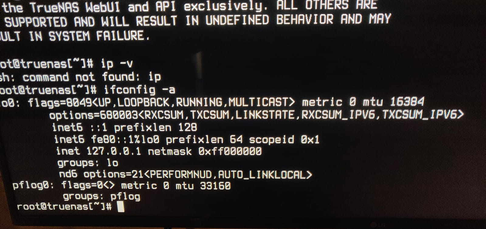

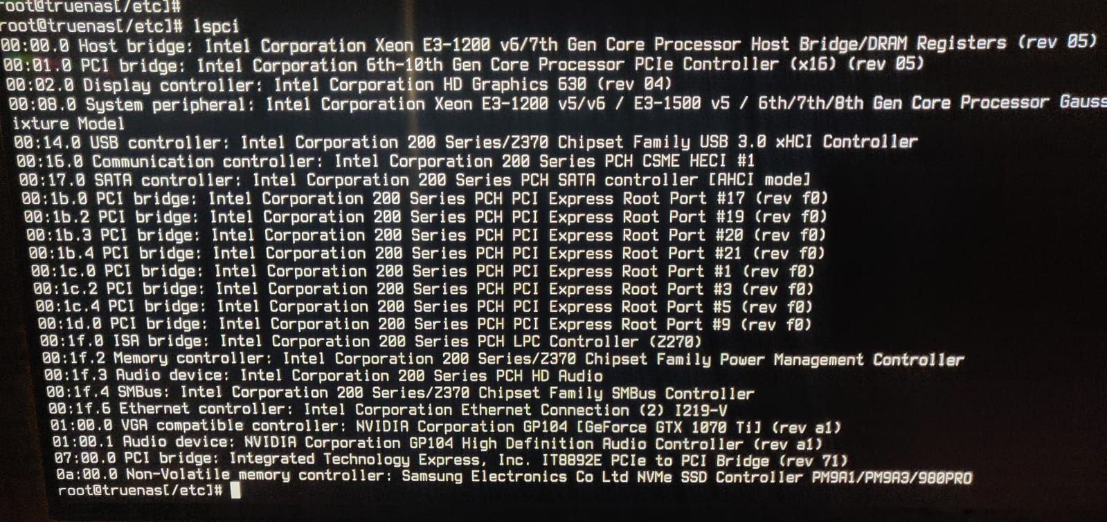

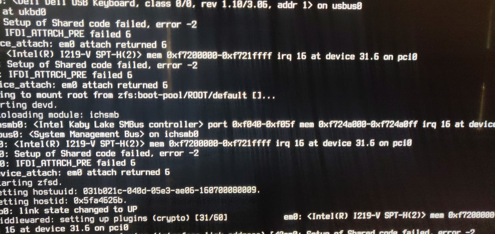

Today i tinkered with some settings, added ISCSI, enabled the service in TrueNas, and in my pc as well , it connected, and worked, i even transferred a file (28gb), and canceled it in the middle of the transfer. (still saw what was Transferred in the drive ~ 2.9gb). but after deleting what was transferred (like 10 minutes afterwards) , the connection to the TrueNas computer dropped.
and that is where my problem lays , i'm not sure if it is a bug or the ethernet port just decided to die (in a weird time).
My troubleshooting steps:
Checked there is internet on the computer im was on, there was, checked the router for online devices, saw the NAS Computer is offline, went to the NAS computer.
I Saw the ethernet port on the NAS Computer had constant orange light, i rebooted the NAS, and since then , no light showed on that port anymore.
i tried to switch ethernet cables, connect to a different ports on the ISP Router and than started to troubleshot in the NAS Computer itself,
in it, when checking the network configuration (1), nothing shows up.
sadly i don't have a NIC to test with.
Attaching some information i gathered from the Shell (9)
i got no idea why it was caused, it seems like it was disabled or something without my knowledge \ the port died?? (I'm a bit noobie, so hopefully i will learn something new).
