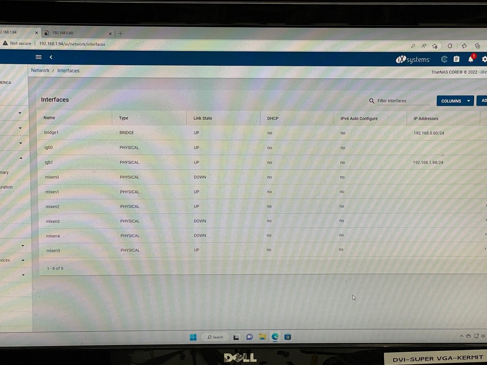

I could really use some help. I setup a bridge using the GUI. I have 3 Mellanox X2 dual port cards. System B connected to my switch with a fiber cable. System B is connected to my server. That server has Mellanox X3 dual port card and one port connected to an Aruba switch and the other to System B. System B performs perfectly when connected but does not work after I create the bridge on system B. Attached is a copy of the GUI screen and the ifconfig showing that the bridge is setup. I cannot ping the 192.160.0.60 address from any remote system. I can talk to the gui on address 192.168.1.94 from a system on that subnet.
I always have the issue that I cannot configure the bridge using the GUI to. When the network interface gui goes into test mode, the network reconfigures, and I cannot press the save button because it is no longer on that address. I cannot configure two interfaces to the same subnet. I connect to the GUI on the x.x.1.x subnet. This does not get reconfigured and I can save the config. The bridge is then persistent. I can configure the address I want through the 192.168.1.94 address. I have had this setup working in the past but I reloaded SW and now I cannot get it to connect.
I am about ready to give up on setting the bridge via the gui and go back to a script or buy a darn switch. I would really like to get this to get setuo reliably. I was hoping for some help.
9,700

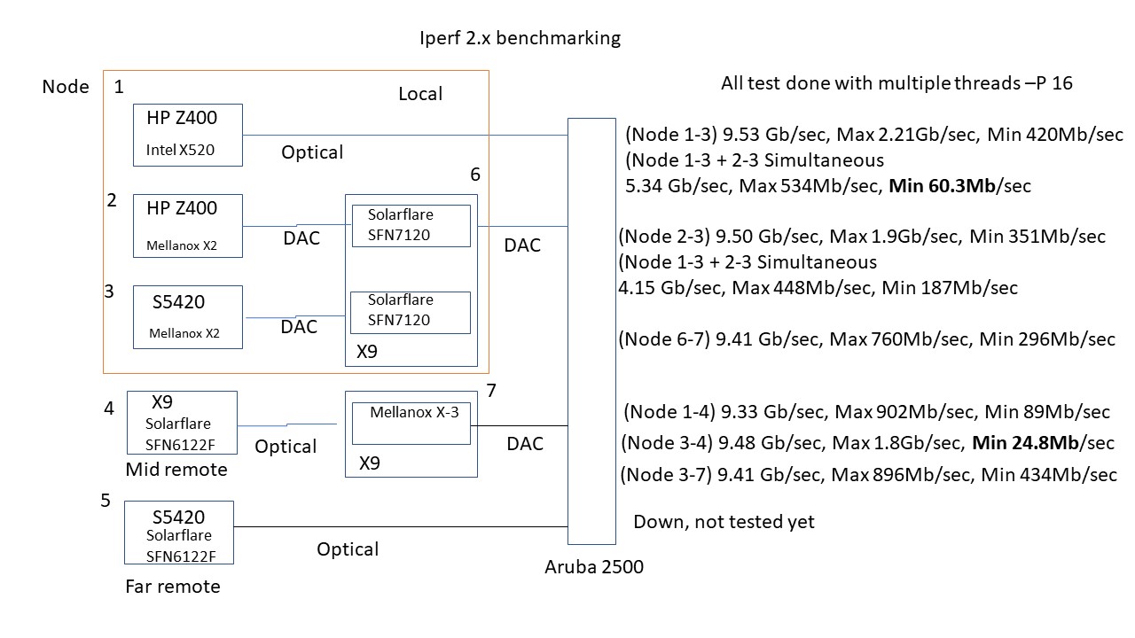

Thanks for responding. Here is my diagram. I am connecting from my windows client 192.168.1.78 to the 192.168.1.94 1Gbs port on my server to create the bridge on my working network 192.168.0.x . When I do it this way I am always connected so I can respond after the network changes are tested. I set the bridge created in the gui to fixed IP 192.168.0.60 because I don't want my shared drives to change. the problem is that I could not access the network from the 10Gbs clients on the bridged ports.

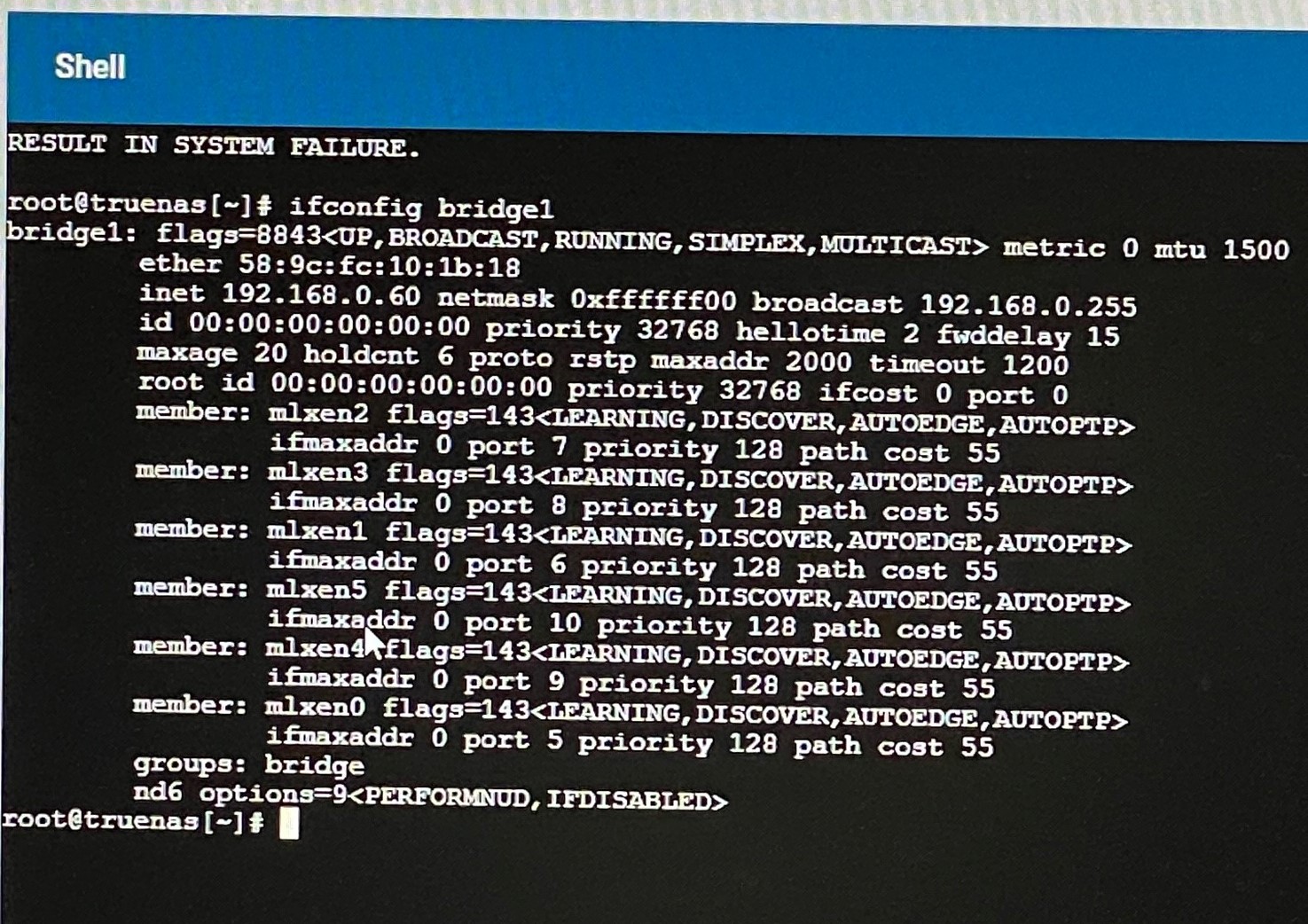

I then decided to manually set up the bridge with the shell commands. This is not permanent but I thought might help. I examined the script I used to use in FREENAS 11. It included specifically declaring each port in the bridge as up. "ifconfig mlxen0 up" ifconfig mlxen1 up" etc
Once I did this the bridge worked perfectly.
On each reboot I have to repeat this using shell or create a script. I don't know if the bridge will be created before the script runs. That is a project for tomorrow. I had tried to setup the bridge on some solarflare cards. that did not work. perhaps it was the same issue. I'll try that again because the solarflare physically works better.

This is the script info. https://www.truenas.com/community/threads/bridge-between-network-interfaces.41566/page-2#post-570639
One of the comments in this thread seems to say I can add the "up" to the bridge creation. I'll give that try as well
Update: I added the up command in each of the mlxen0-mlxen5 ports in the Interfaces section of the Truenas GUI. Now the bridge works properly. The system running the bridge SW should be up before the clients to connect properly. if it is not, I had to enable/ disable the port on my Windows client. On a connected Truenas machine I had to reboot it. I did some brief performance testing, looks like I have some work to do.

That was not sufficient. The bridge does start in the up state.
I added the up command in each of the mlxen0-mlxen5 ports in the Interfaces section of the Truenas GUI. Now the bridge works properly. I had no trouble with a bridge on a different machine which is why this was puzzling. I am wondering if it is related to the fact that I am using multiple network cards in this system and that system has a single dual channel network card.
The system running the bridge SW should be up before the clients to connect properly. on a different Truenas system. if it is not, I had to enable/ disable the port on my Windows client to get it connected. On a connected "client"Truenas machine I had to reboot it. I did some brief performance testing, looks like I have some work to do. The Windows machine has a dog of a disk. I was only able to get 115MB/s transferring a big file

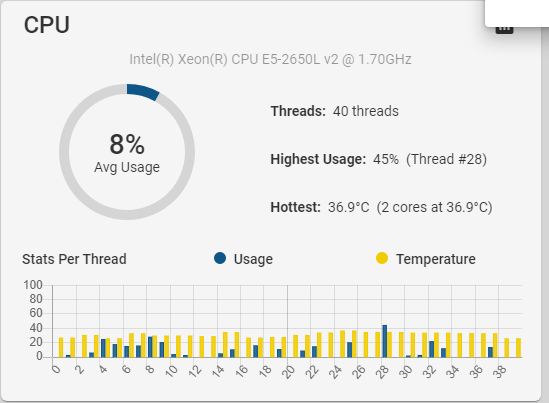

I upgraded from the Solarflare SFN6122F to the newer PCIE 3.0 SFN7120 cards and the network performance went up significantly. Instead of peaking at 7-8Gb/s. I was able to achieve faster. Here is the performance chart and graphic. With multiple threads the full bandwidth is achieved. Seems the bridged bight have more variance when heavily loaded but surely adequate for me. I plan to add 4 more clients to the node 6 server. I hope this helps other understand better the performance capability of the bridge method of creating a switch. We'll see how well this bubble gum solution holds together over time. The cost during iperf testing with two different paths with 16 threads wis about 8% CPU. I don't think the server felt too abused.

I wanted to test the difference between the performance of the bridge and 10Gb switch. I could not see a difference in the iperf testing. I then used large file disk transfer to test SMB network drives. There was a lot of variation. I repeated the tests with the Tp-Link 10Gb switch. I saw similar variations but overall higher performance. I then used Crystal Disk to test local and network drives. The G drive is a nVME drive so I knew if I tested transfers from that drive the network would be the bottleneck not the disk drive. The surprise was that the single drive SSD pool performance was the same as the Truenas spinner pool. That must mean that the 415MB/Sec (Read). 500MB/sec (Write) is the network bottleneck.
My Takeaways-
- A truenas bridge can be used as an effective 10Gb switch. Performance is not as high as a real switch but it is pretty good. uses lless that 3% of cpu. Cost for 8 ports $160
- If you only need 8 SFP+ ports a new TP-link or Mikrotik Switch will be more economical than a Bridge $225-250
- Surplus switches are power hungry and noisy compared to a modern switch.
  • Benchmark of networking.pdf
