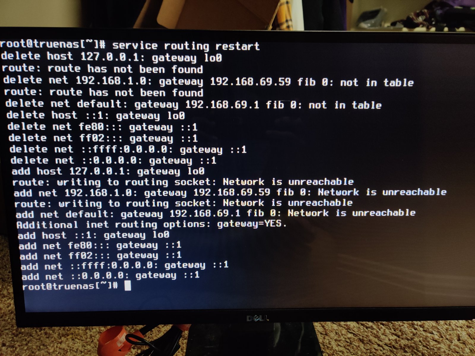

Running Core on a SuperMicro x10sri, I'm using an Intel 2.5GHz NIC before I attempted to change to Link Aggregation.
The run down was trying link aggregation out with the dual gigabit ports on the motherboard, so I set it up through the console directly. Failed, and on the way thought I needed to clear out the settings for my NIC for some reason, tried again and failed. So I decided to scrap the plan until I do more research and just go back to using my NIC, but now my network settings are probably all messed up from clearing those settings.
I attempt to use option 1 for "Configure Network Interfaces" setting it up with the IP it's been using before. Will hang for a second, then say "Restarting Network Failed" It will just spew out that the GUI is accessible by 192.168.1.1, my network has been setup to 192.168.69.x so that wont work. Changing default routes doesn't seem to fix it either. Temporarily changed the router to 192.168.1.x to get something out of it but still the same errors and address.
Another possible clue is I'm getting errors every now and then for default@duckdns.org (what I use for dynamic DNS), waiting for it to come by so I can send a screenshot of it.
Attached what I get from using
service routing restart
I'm like 90% certain there's just one setting that I'm too blind or oblivious to that fixes the whole thing, and my head hurts already. Once the GUI can be at least accessed, I think I can get everything else back in order. Not sure what else to provide to help out, will send any info needed.
