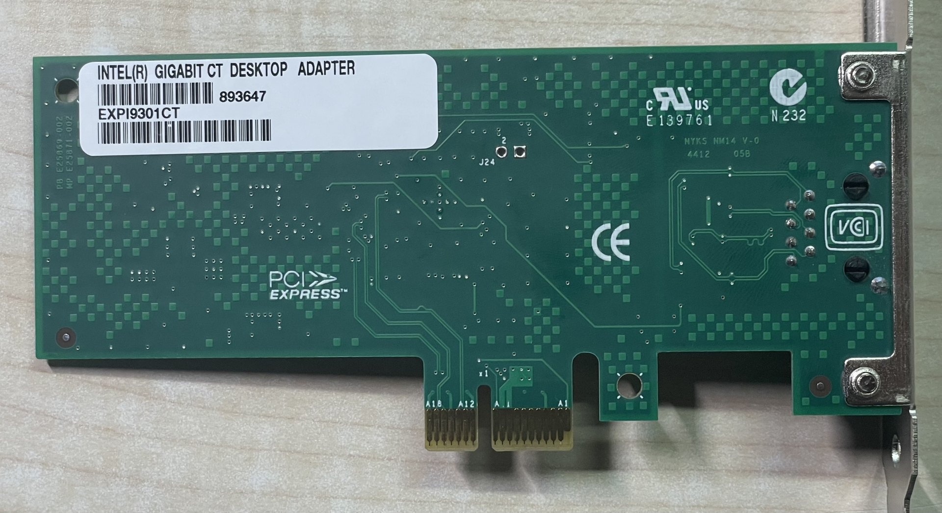

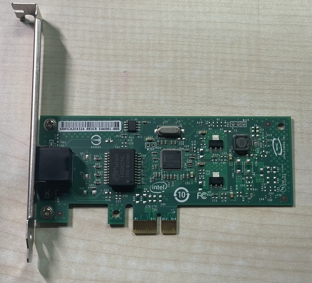

Network card:

Network card:
My feeling is: that's probably a fake card. The lack of an Intel Yottamark sticker is highly suspicious, the soldering of the QFP looks uneven and unprofessional, and the jack looks like something that came out of a Shenzhen penny bin.
You might try to find a CT from an alternative manufacturer like 10Gtek. I am not aware of there being fakes of these; the honesty of it "not being a true Intel card" plus that they are a known Intel manufacturer might bode well. Their cards are like
I think it's quite possible now that you pointed it out. It might be a fake, or a defective one that supposed to be disposed. But somehow it entered the second hand market.
Network cards aren't expensive, so it shouldn't be a deep cost to purchase a new (and quality) one, as an example in the previous post by @jgreco. Plus, they're a very, very critical part of your NAS.
True... I probably should buy something better and with a warranty this time. Perhaps upgrade to 2.5G at the same time? Though I'm still reading reviews and haven't decided on anything yet.

So I think we've determined earlier that this was probably a knockoff card. Sorry you had to go through the time and annoyance. I'm going to tag this thread into my "Fake server cards" resource because we occasionally get folks who just won't believe it. I agree it doesn't happen super often but it does happen.

Network card:
View attachment 67495 View attachment 67496

The network card is most likely a fake (see that link) and known for early failure. The card you have appears to be a more recent clone that looks more accurate than previous. The network card clones-like LSI HBA clones-appear to be manufactured from inferior (cheap) components and "live a productive, though short, life."
