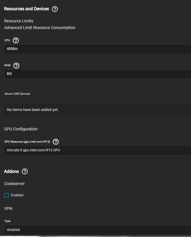

Resources and Devices (all at default)
- CPU - 4000m (default)
- RAM - 8Gi (default)
- Mount USB devices - nothing added
GPU Configuration
GPU Resource (gpu.intel.com/i915) - Allocate 9 gpu.intel.com/i915 GPU (default)
Addons
Nothing checked or selected as default
Advanced

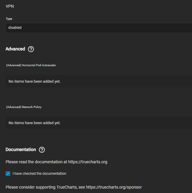

When I bring up the log I get a pop-up connection error: kubernetes.pod_log_follow:{"release_name":"tailscale", "pod_name":"tailscale-5688c7bfb7-j4ctz", "container_name":"tailscale", "tail_lines": 500} nosub
I am still unable to access the CLI with the same error message above,
I removed the machine from tailscale.com & restarted tailscale app, but same error message and stuck in deploying.
I can't find a recent guide that has a bit more information on the options and all the YouTube videos have slightly different options from the current version of tailscale. The tailscale forum site has no replies for any of the TrueNAS/Truecharts questions posted. It's so easy to set up on iOS and Windows devices. I can't set up a virtual machine on this system and would like to use a single package for my little setup.
Any help would be appreciated - I don't want to break my TrueNAS installation again

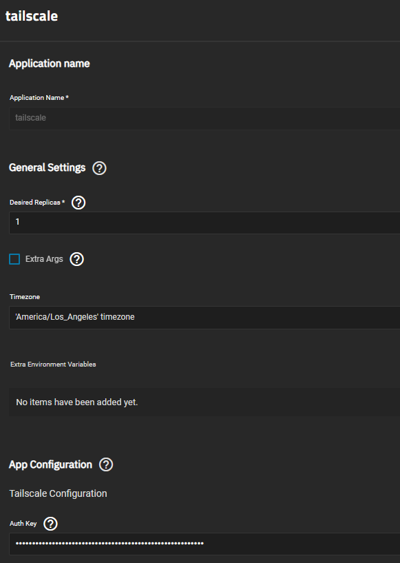

tailscale setup - Apps
Application name: tailscale
Desired replicas 1 (default)
Extra Args (not selected)
Timezone: America/Los_angeles'timezone
Extra Environment Variables (nothing)
App Configuration
- Auth Key (master key entered - worked first setup)

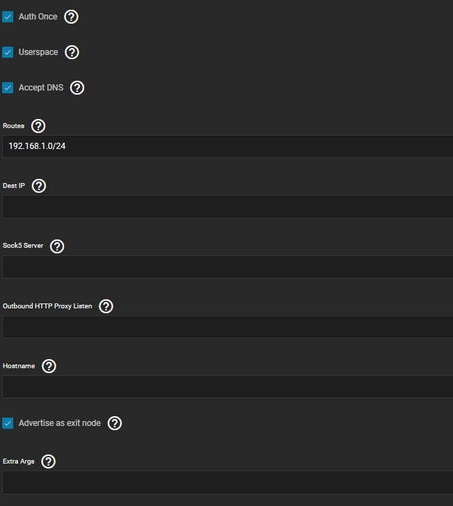

- Auth Once checked
- Userspace - checked
- Routes 192.168.1.0/24
- Dest IP blank
- Sock5 Server blank
- Outbound HTTP Proxy Listen blank
- Hostname blank
- Advertise as exit node checked
- Extra Args blank
- Tailscale Daemon Extra Args blank

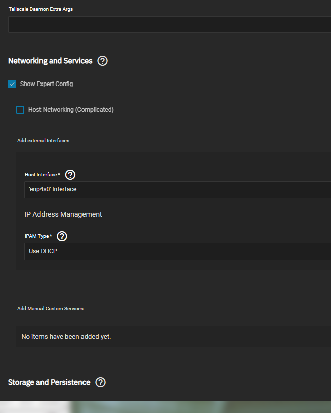

Networking and Services
- Show expert mode checked
- Host-Networking not checked
- Host Interfaced - added 'enp4s0' Interfaced --> Added
- IP Address Management IPAM Type - Use DHCP selected --> selected
Add Manual Custom Services - none added

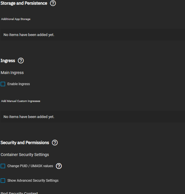

Storage and Persistence (all at default)
- Additional App Storage - nothing selected
Ingress

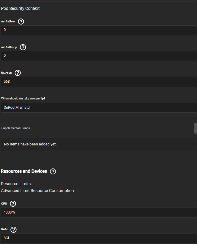

Security and Permissions (all at default)
- Change PUID/UMASK values - not checked
- Show Advanced Security Settings - not checked
- Pod Security Context
runAsUser - 0 (default)
runAsGroup - 0 (default)
faGroup - 568 (default)
Whenshould we take ownership - OnRootMismatch (default)
Supplemental groups - none added
GPU Configuration
