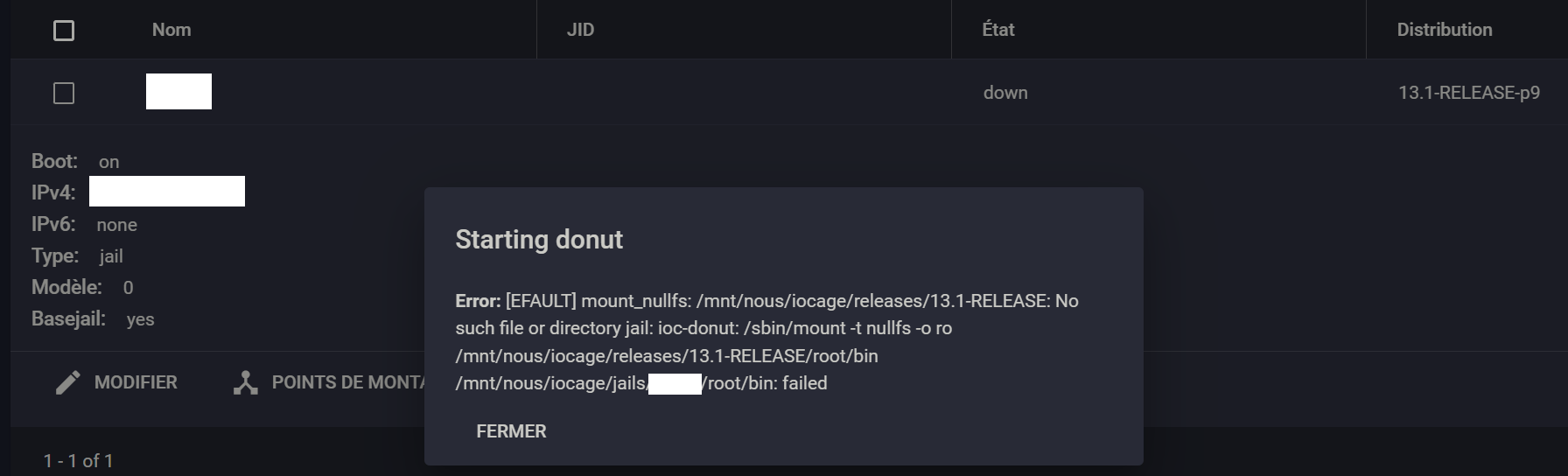

Hi everyone
I wanted to upgrade the data pool of my TrueNAS-13.0-U6.1 server from non encrypted to encrypted.
Backuped all data and exported my apache webserver jail, deleted pool and create new one then imported my jail but it won't start because 13.1-RELEASE files are not there.
I tried this :
root@...[~]# iocage fetch
[0] 12.4-RELEASE
[1] 13.2-RELEASE
[2] 13.3-RELEASE
[3] 14.0-RELEASE
Type the number of the desired RELEASE
Press [Enter] to fetch the default selection: 13.1-RELEASE
But pressing Enter doesn't work at all.
root@...[~]# iocage fetch -r 13.1-RELEASE
13.1-RELEASE was not found!
No success either...
Is there any other way to fetch 13.1-RELEASE ?

Updating the jail requires existing release files :frown:
Error: mount_nullfs: /mnt/nous/iocage/releases/13.1-RELEASE: No such file or directory jail: ioc-donut: /sbin/mount -t nullfs -o ro /mnt/nous/iocage/releases/13.1-RELEASE/root/bin /mnt/nous/iocage/jails/donut/root/bin: failed
