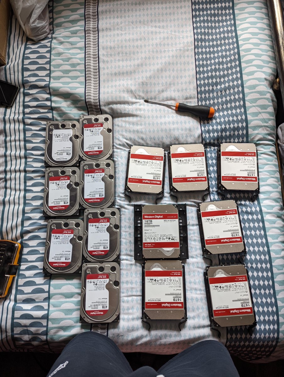

I installed 7 16TB drives, I have 8 drives in total and one will become a cold spare as mentioned after restoring the data. I am glad to hear they are working on a feature to add drives to a pool. I have created a single pool with the 7 drives in raid Z2, this has resulted in 65.7TB of storage, does this seem low to you? I was expecting 72TB. I also created the Pool, Data Set, and SMB share with mostly all basic standard config settings, is there anything you think I should do specifically for my use case? I won't be populating with data until I hear a few responses,

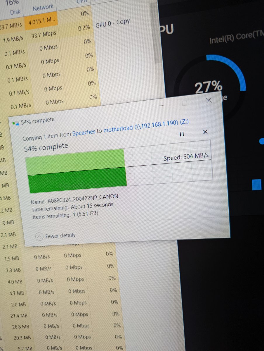

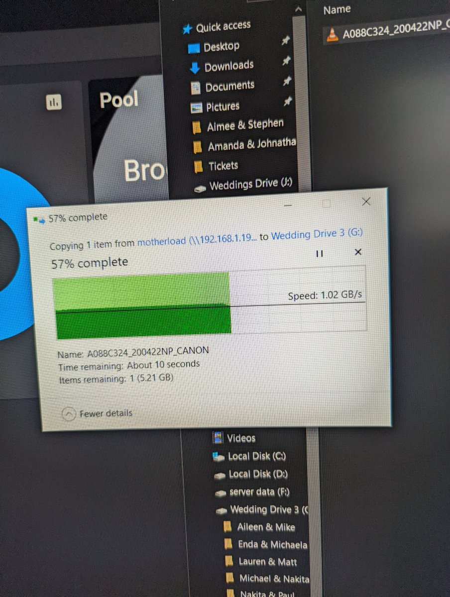

Overall I have to say the project is a big success, the photos attached show my read and write speeds from a quick test, 500MB/s Write and 1.1GB/s Read!! I will update the thread with more speed tests as I populate the server.
