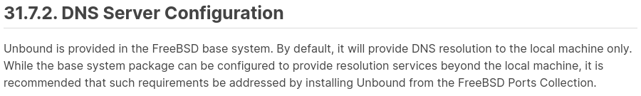

Or create a jail and install AdGuard Home which comes with a nice UI. It needs an upstream recursive DNS server, but local-unbound is bundled with FreeBSD and can serve that role.
If I'm not mistaken, doesn't PiHole also come with a web UI? I have never used either, but heard such about them. Hmm, doesn't seem pihole is available via the ports though.
Also, local_unbound isn't meant to be used in that manner and more as a local cache. Hence the local prefix. The handbook advises you to use Unbound from the ports instead.
Here's the relevant snippet from the handbook concerning that:
If its use with AdGuard is similar to its use with Pi-Hole, unbound would be providing lookups only for AdGuard, which would then serve them to the rest of the network. But that's just a (somewhat informed) guess.
