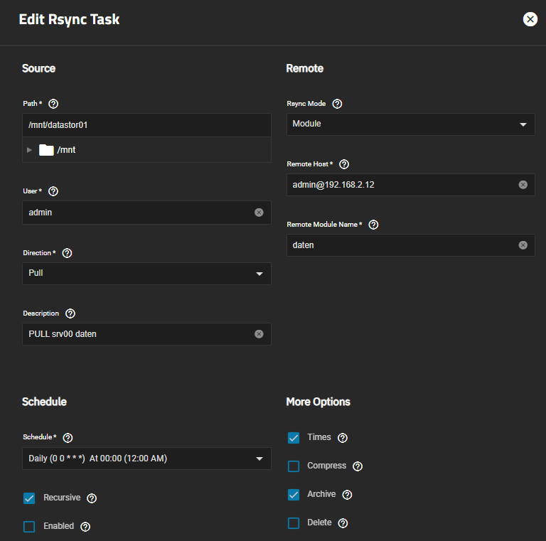

i have created a rsync job to PULL files from my old storage 192.168.2.12 .

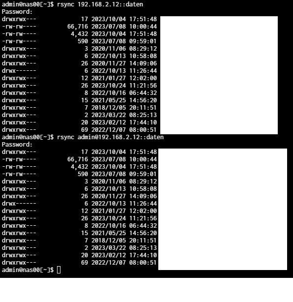

if i try to connect in shell on truenas server (up to date) , i can connect to the rsync module on 192.168.2.12.
The job runs into the error
Truenas
Password: u/ERROR: auth failed on module daten rsync error: error starting client-server protocol (code 5) at main.c(1863) [Receiver=3.2.7]
Server
2023/10/27 20:56:38 [151186] rsync allowed access on module daten from UNKNOWN (192.168.2.71)
2023/10/27 20:56:38 [151186] auth failed on module daten from UNKNOWN (192.168.2.71) for admin: password mismatch
Truenas rsync job created via gui must do something wrong i think. or i have other problems/mistakes in the jobconfig (see attached files).
thx for your help

Oct 22, 2019
3,641
I don't understand the first screenshot?
1. Are you using "strict modes" on the rsyncd server? (It's enabled by default.)
If so, what are the permissions/ownership on your secrets file?
2. Are you using any special characters for the password?

the first screenshot is the test of rsync connection from the truenas to the source. it works fine in shell.
.cmd1
password prompt -> input secret -> success, module file can be listed
cmd2
rsync 192.168.2.12::daten
is the same, only without user, so it chooses the user of shell.
test with user christian also ok
1. yes, strict modes on and the rights are ok
permissions on secret file is ok, authentication in shell of truenas works

Oct 22, 2019
3,641
Wait, did you specify a secrets file (that has the matching password) on the auxiliary parameters in the Rsync Task?
(Your screenshot is cropped.)
chris1284
Oct 27, 2023
7
Wait,..... what a stupid failureo_O. for whatever reason, i thought the task uses some integrated auth methods.
With option password-file it works. thank you for help!
