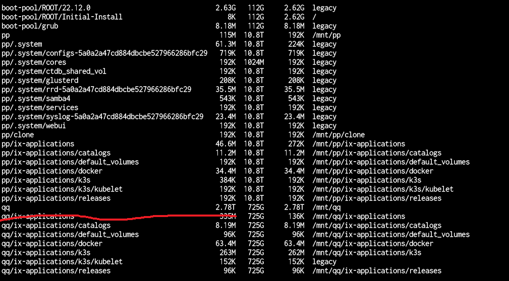

I would start with zfs list
Once you get a handle on what data you have and where it is (from that output), you can help us to understand what you want the end result to be.

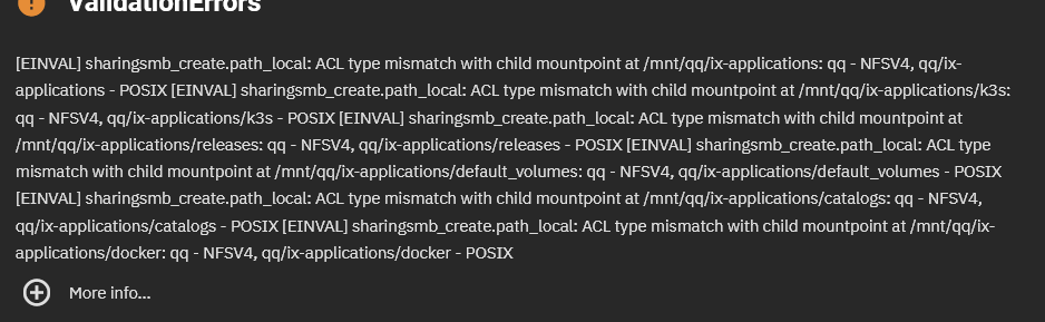

Sorry, for not explaining my setup enough. So pool 1 I called pp, it was 5 3tb drives in Z2. When I decided to replicate it I created pool 2, qq with 3 or 4 small drives (all I had left) with no redundancy. Nuked pool one, read somewhere it's easier to restore if you name the pool the same thing it was. so pool 3 is also pp. No I do not have any apps, but I can't seem to get rid of them from either pool. Every time I try to share qq I get this error:
But you can see in the zfs list that the 2.7gb of data is there. I just don't know how to get to it or do anything with it.
