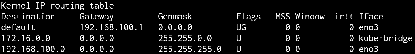

what is your output from netstat -pr with the tunnel running?
loremia
Apr 23, 2023
6
From my TrueNAS Scale A
9,700
So there's nothing in the routing table to catch any packets coming from your NAS and push them into the Kubernetes container that runs Tailscale.
To be fair, the container was designed to support routing for other containers (already inside the kubernetes network), so that's not shocking.
So perhaps it can be made to work by advertising the route of your subnet from the tailscale client (192.168.100.0/24), which is done in your account at tailscale.com (after adding that to the "Advertise Routes" list in the app config).
After you do that and restart the app, does the routing table change?

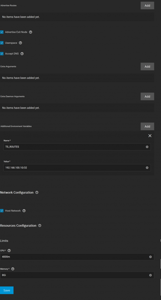

Advertise my nas with 192.168.100.10/32, added the rout from the tailscale.com dashboard but unfortunately nothing changed.
This is how I set up the App

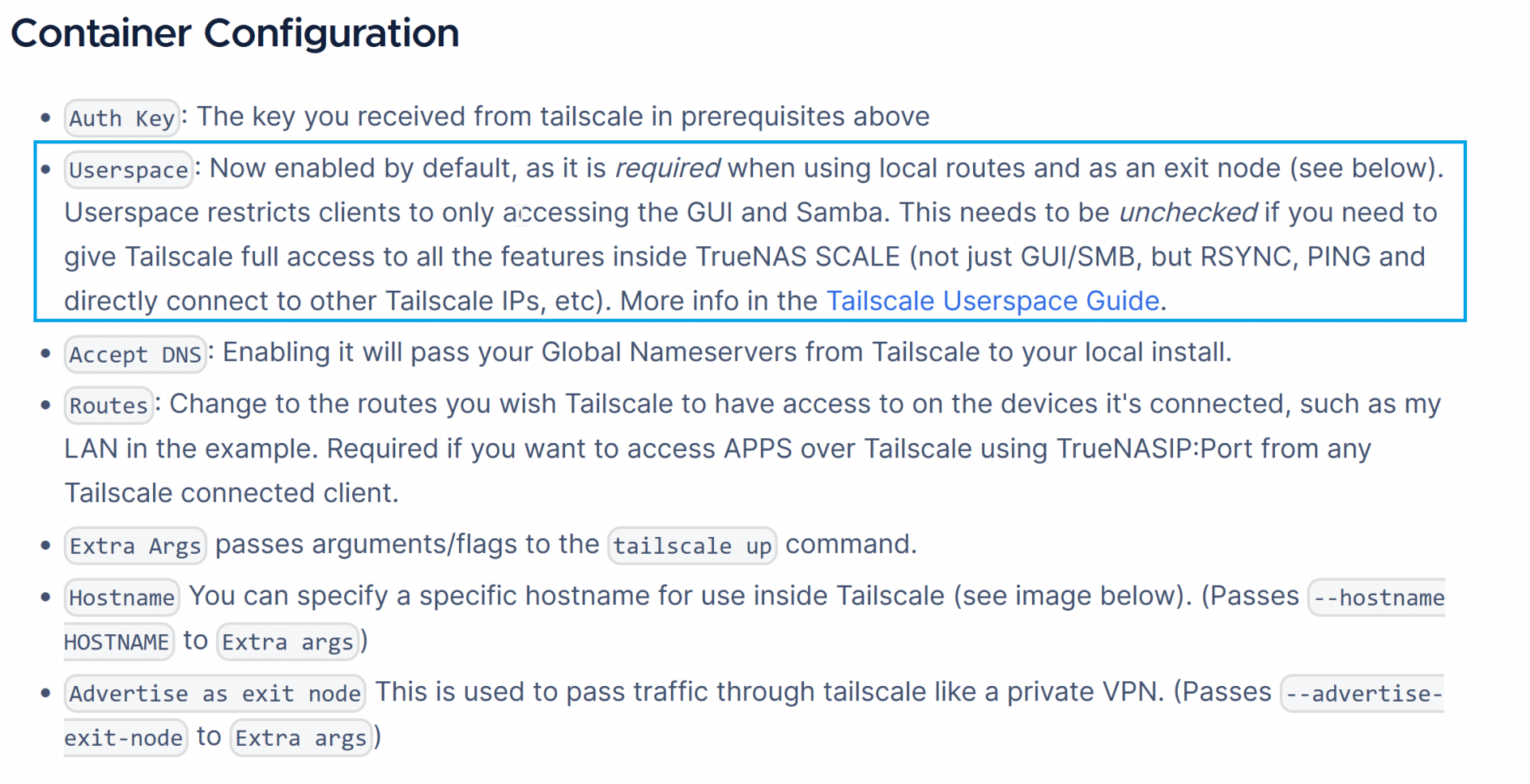

Ok maybe I found the problem.
I will try to uncheck the Userspace variable when I'll be back home and the I will let you know
9,700
That does look like a pretty good explanation of what's happening.

Also, you put the Advertise Routes in the wrong place (although what you did may have worked)... it should be at the top, not in the environment variables.
As we predicted, unchecking the Userspace entry everything worked perfectly (without even advertising Routes!).
