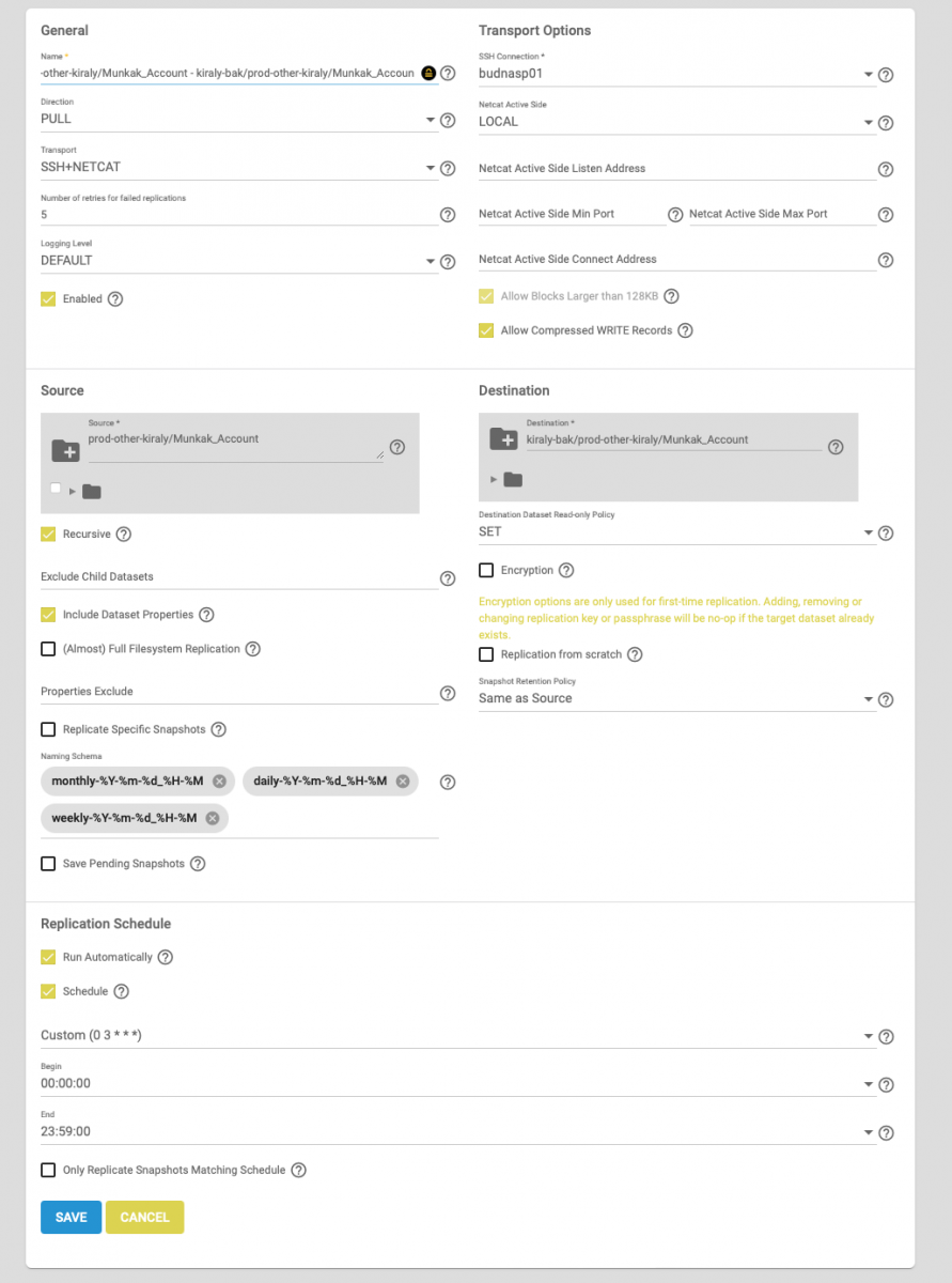

Dear Community,
I am replicating multiple datasets between 2 TrueNAS Core, latest version on both side.
On prod server I have the following snapshot naming conventions.
hourly-%Y-%m-%d_%H-%M
daily-%Y-%m-%d_%H-%M
weekly-%Y-%m-%d_%H-%M
monthly-%Y-%m-%d_%H-%M
For backup server I have set to replicate the following ones:
I have the same setup for all replications but for one of the dataset it ignores monthly-%Y-%m-%d_%H-%M
If I set the task to replicate only monthly-%Y-%m-%d_%H-%M it does its job and replicate successfully but if I have set all the 3 (daily, weekly, monthly) it ignores the monthly-%Y-%m-%d_%H-%M and does not replicate it only daily and weekly.
For another dataset it did the same once then I have deleted entire dataset from bak side and re-created the task and it replicated all 3. I have tried this with dataset as well but it does not work.
Any ideas appreciated. Honestly it hurts to "testing" to deleting dataset since its many TBs so... :/
I have attached the following:
  • screenshot of the configured replication task
  • debug log for the task where all 3 *-%Y-%m-%d_%H-%M configured but monthly-%Y-%m-%d_%H-%M does not replicating (pasted below)
  • List of source snapshots
  • List of destination snapshots
Thank you!

Destination snapshots:
root@truenas-bak[~]# zfs list -t snapshot kiraly-bak/prod-other-kiraly/Munkak_Account
NAME                                                                  USED  AVAIL     REFER  MOUNTPOINT
kiraly-bak/prod-other-kiraly/Munkak_Account@weekly-2023-04-09_00-00  9.80M      -     8.39T  -
kiraly-bak/prod-other-kiraly/Munkak_Account@weekly-2023-04-16_00-00   186M      -     8.40T  -
kiraly-bak/prod-other-kiraly/Munkak_Account@weekly-2023-04-23_00-00  97.3M      -     8.47T  -
kiraly-bak/prod-other-kiraly/Munkak_Account@weekly-2023-04-30_00-00  21.7G      -     8.61T  -
kiraly-bak/prod-other-kiraly/Munkak_Account@weekly-2023-05-07_00-00   512K      -     7.81T  -
kiraly-bak/prod-other-kiraly/Munkak_Account@daily-2023-05-08_00-00    439K      -     7.81T  -
kiraly-bak/prod-other-kiraly/Munkak_Account@daily-2023-05-09_00-00   1.16G      -     7.81T  -
kiraly-bak/prod-other-kiraly/Munkak_Account@daily-2023-05-10_00-00    813M      -     7.84T  -
kiraly-bak/prod-other-kiraly/Munkak_Account@daily-2023-05-11_00-00    670M      -     7.92T  -
kiraly-bak/prod-other-kiraly/Munkak_Account@daily-2023-05-12_00-00      0B      -     7.93T  -
