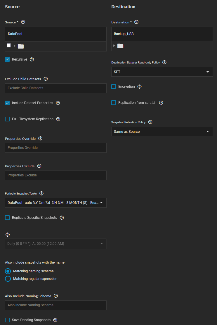

How did you configure the Replication Task?
Can you show a screenshot of all its settings?

Well sure.
I mean there is nothing special ... i tried also to use full file system as an option or changed read only to ignore without any change.
Is there any solution for this (encrypted)? otherwise i would bite into the apple and rebuild the hole pool by creating a new unencrypted one but i dont understand where should be the problem here? its just a block level job to sync two datasets no matter if the files where encrypted or not ... okay perhaps the os needs an identifiyer to know whats necessary.

This is because you're trying to overwrite a root dataset ("Backup_USB"), which is not possible. (You can't even do this for non-root datasets if there is encryption involved.)
You need to "nest" your destination, so that the first time you run the replication task it will create a new nested child underneath "Backup_USB".
To do this, you can manually type /DataPool or /DataPoolBackup (or whatever you prefer) in the destination field, so that it looks like this:
  • Source: DataPool
  • Destination: Backup_USB/DataPoolBackup
It's for this reason I use my pseudo-roots method, for more intuitive management. Because, guess what? When you want to "restore" the backup to a newly created pool, you won't be able to maintain the same structure. (You won't be able to "replace" the new pool's root dataset with your backed-up root dataset.)
