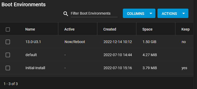

mangof60
Jun 2, 2023
16
The latest one I have is from 2022-12-14 which is the same date as the backup config and keyfiles I have (which are the ones I'm trying to use to decrypt but aren't working)

Apollo
Jun 13, 2013
1,458
Normally, if you go through multiple updates/upgrades, then you will get more selection amongst your list of Boot environment.
However, seeing what you have, Default would have been a good ooption, but I douobt it contains much data as it doesn't use a lot of space. You can try the "Default" and see if you can reboot and have the drives already imported.
Otherwise, I would try checking if you have any snapshot that could exist on your boot drive. (I might have been wrong about the creation of snapshots during update/upgrade.
However the Boot environment seem to be stored under "freenas-boot/ROOT" folder structure.
If you have snapshots, which you can list with:
zfs list -t snapshot -r freenas-boot
Then you might be able to clone the most recent one to look for the keys and such.

Oct 22, 2019
3,641
But you have some from earlier dates (according to your screenshot.) Though they might be from before you made any pools.
