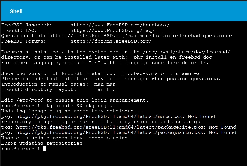

So after todays update to 13.0-U1 i was finally able to access my VM again, but ive run into another issue ! when trying to update plex with my usual method of "pkg update && pkg upgrade" it says it cant find repository. i think this was present before updating today though. i then tried stopping the plugin and jail and updating them from the gui, but it comes up with an error (too quick to read) and the GUI to truenas goes blank and says trying to connect (like when rebooting) then when it returns the plugin/jail is running again and i dont think it updated.
Could it be that the plugin is too old to find repository?

oh an heres what it says when updating

Your plugin is still on FreeBSD 11, which is way end of life. From the host, try iocage upgrade -r 13.0-RELEASE plex to upgrade it to the latest release. After the upgrade completes, you can enter the plugin via iocage console plex to run pkg update and pkg upgrade.

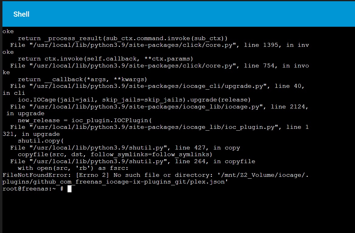

if i try "iocage upgrade -r 13.0-RELEASE plex" i get this error
... iocage pkg plex upgrade, gets a similar error as original upgrade method

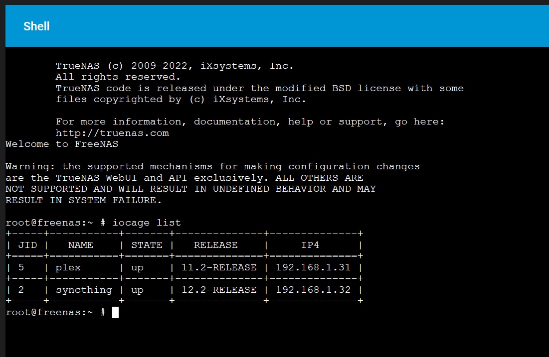

What's the name of your plugin? Try iocage list.

Just plex, it is the plexpass/beta version though

OK, you'll need to rename the plugin to match the Github repo. Try iocage rename plex plexmediaserver. Then try the upgrade above, but with the new name.

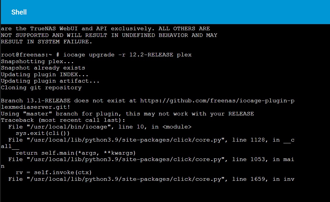

Ah, looking at the plexmediaserver plugin git, it expects 12.2-RELEASE. Try that release with the upgrade command instead of 13.0-RELEASE.

So i tried iocage upgrade -r 12.2-RELEASE plex , then i tried iocage upgrade -r 12.2-RELEASE plexmediaserver then changed the name back to plex and tried the first one again, which had the biggest response, but it was similar to before saying error file doesnt exist in that location, but i did notice at the top, it said this (see pic), indicating perhaps a mismatch
i think i might just remake it as sretalla suggested, do you know of a way i can transfer my data from current jail into the new one
