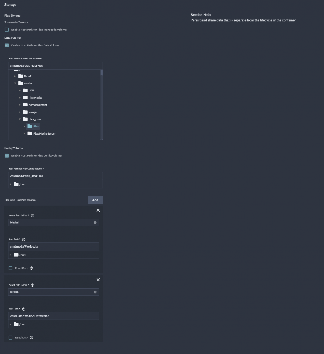

Is something wrong with mount config?
Yes.
Your screenshot shows that both of your mounts don't have an absolute container path.
You show the mount paths as Media1 and Media2.
Those must be /Media1 and /Media2 if it is going to work...
I have no idea how that has been working so far, but it's clear that the latest version is doing a check which you then fail with that config.
Jan 29, 2024
6
That was the issue for me as well. Mine was just media. I add the forward slash and it updated.

Yes.
You were right, thank you! It helped. Strange enough, plex is now working much faster... ;)
9,700
It seems safe to say that until the latest version, if a leading slash was missing, it was added automatically somehow to make things work in the background... maybe that's still the case, but the latest version now checks the mount path and won't continue if it's incomplete.

Yes.
forward slash fixed everything for me too, thanks!

Yes.
Thank you... This also fixed my issue. It's been working all this time without the /
