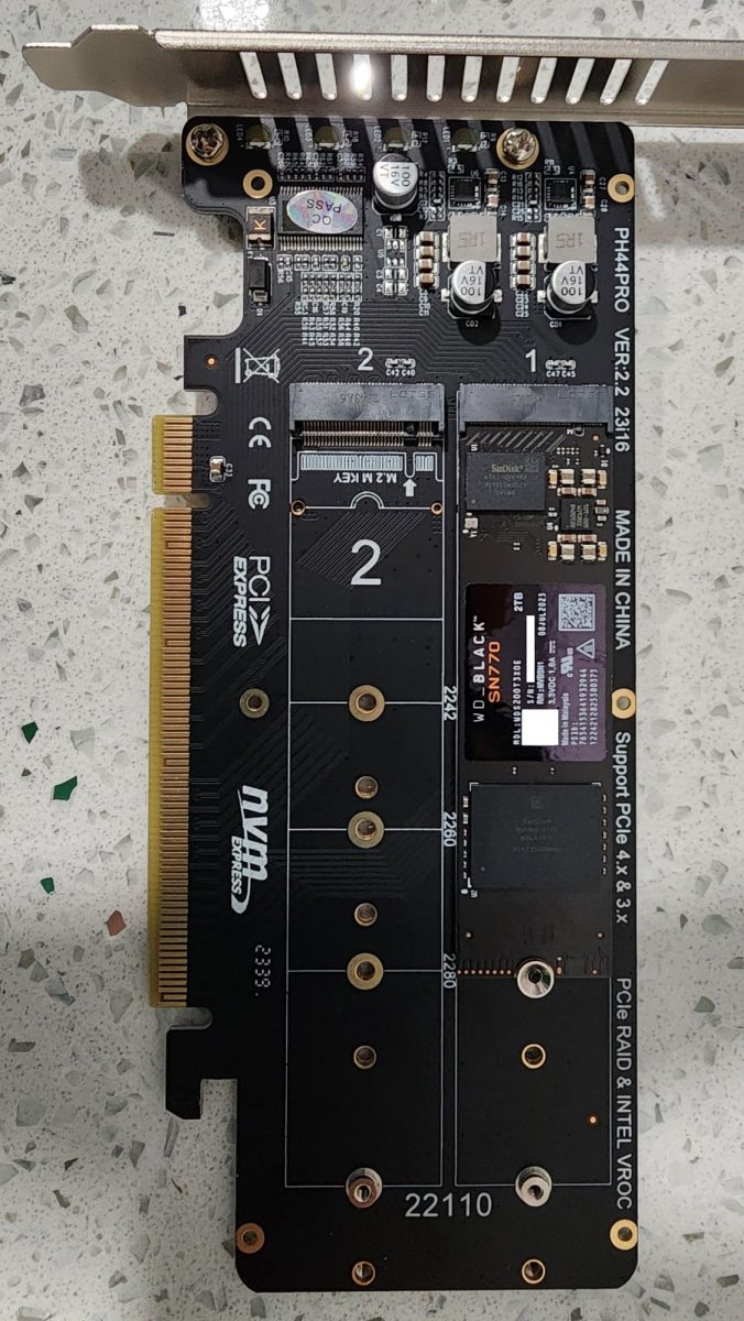

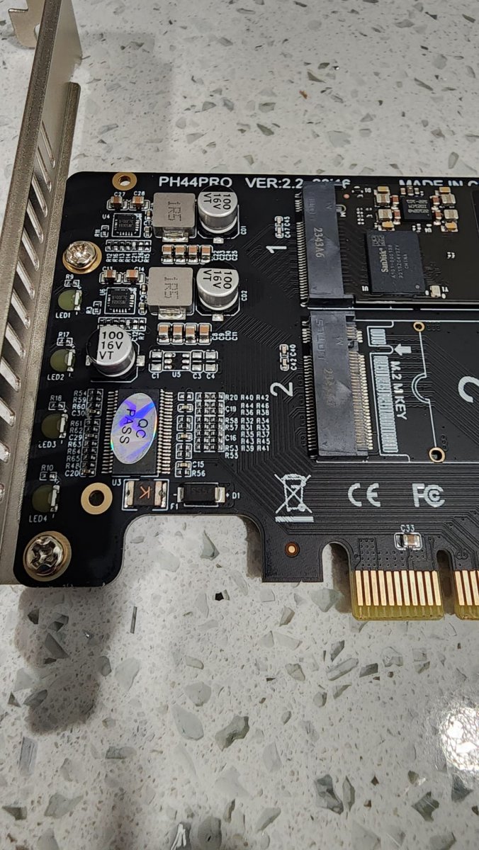

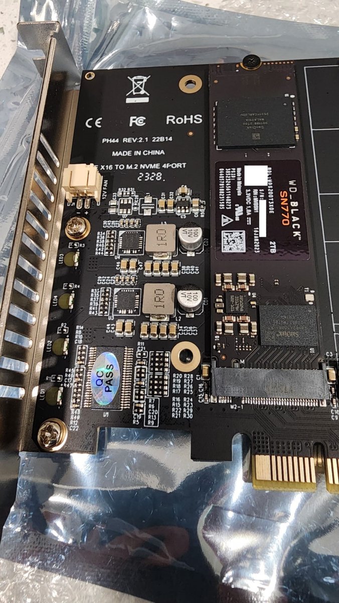

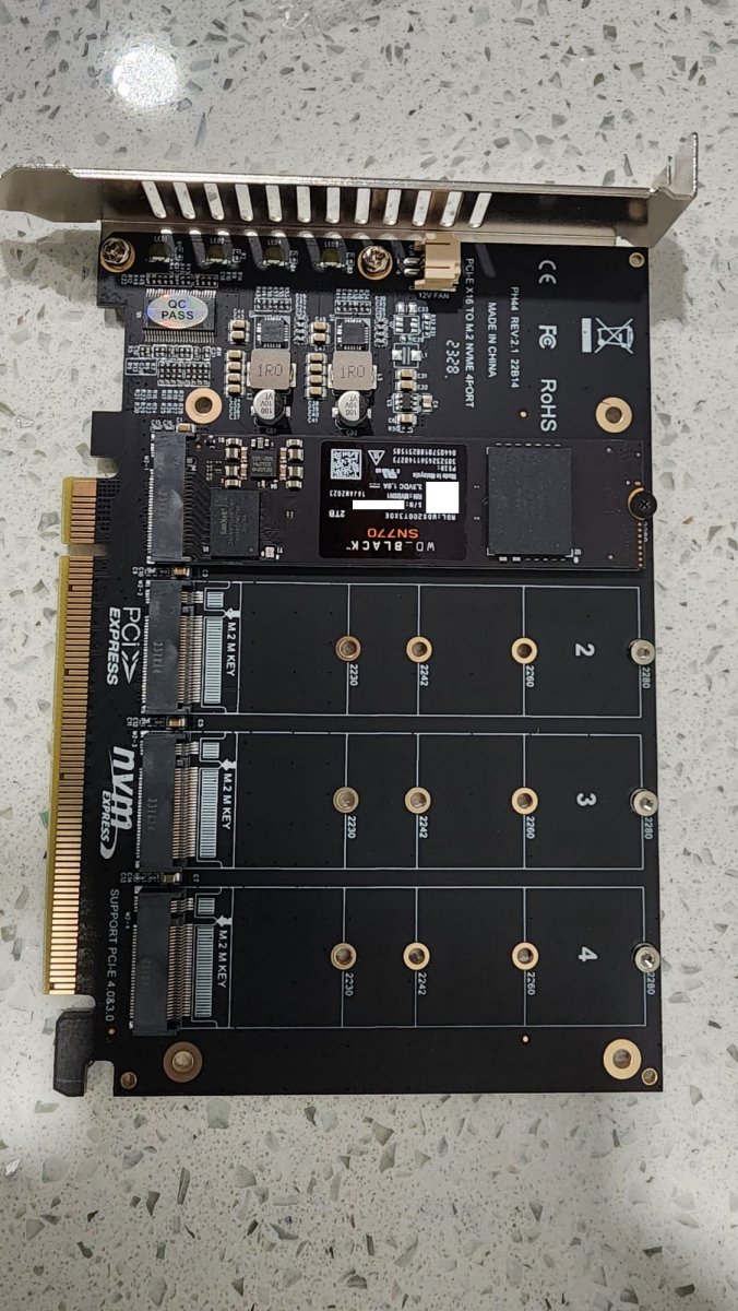

Can you link the card in question? If it's one equipped with a PCIe switch, then you'll want to disable bifurcation.
I tried two different cards. I tried every combination of NVME drives, 2 on 1 card. 1 on each card. In PCIE slot 4 in PCIE slot 6. In any scenario. It only shows a single card.
Thank you for taking the time to investigate. It is very frustrating!

Looks like a generic bifurcating riser. Based on some searching, it appears that you aren't the only one having issues with this specific hardware:
https://www.reddit.com/r/homelab/comments/fs3lru/how_to_get_6_nvmes_working_in_the_r730_1_turn/
According to this user on Reddit, they weren't able to get their 4x card (ASUS HyperX M.2 V2) to function in either x16 slot. They went back to Supermicro 2x cards in the x8 riser slots, and enabled bifurcation on all of the riser slots (even unused ones) - this combined with some on-card jumper settings and UEFI mode resulted in success.
