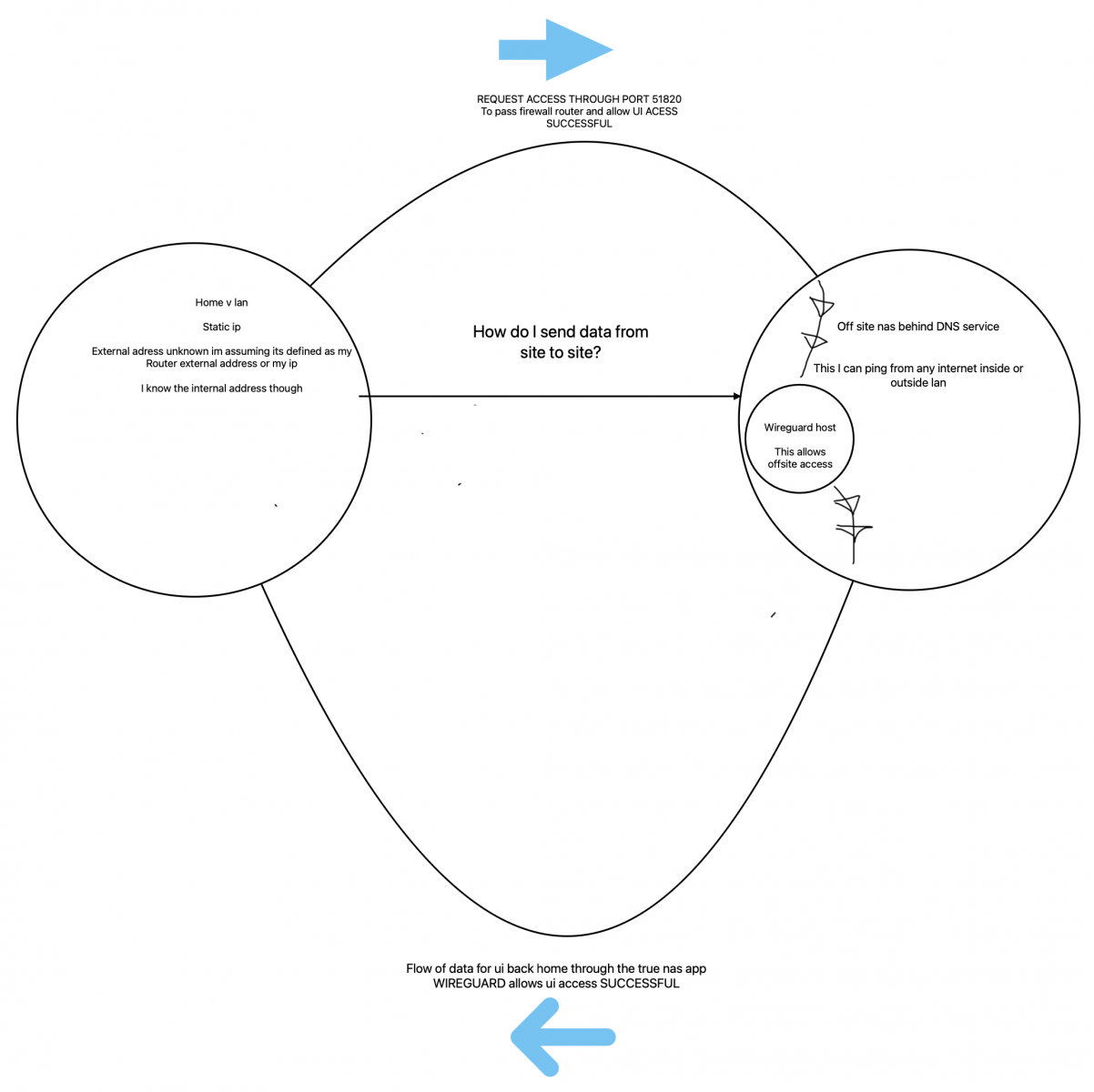

so this would be my nas. i will do a topography pic this might help clear it up

i can ping the router yes, that the nas is behind, and I can wireguard into my nas from outsite, but again im ot sure if i need to open ports or something , cause the nas offsite in one way (wireguard) can see the internet but using the adress of the offsite router or the dns i canbt creat a ssh into that nas
wait a min Ive static routed the 192.168.x.xxx to my router on my network is that right
and the adress you mean there by the adress of the nas is the home wireless router that routes to the nas?
cause the only adress of the nas i can see is an internal adress pointing outwards to the router then being port forwarded via wireguard
so wheere is my truenas adress is this a setting somewhere
I can ping the router yes, that the nas is behind, and I can wireguard into my nas from outsite, but again im ot sure if i need to open ports or something , cause the nas offsite in one way (wireguard) can see the internet but using the adress of the offsite router or the dns i canbt creat a ssh into that nas
|TrueNAS URL that is what I'm missing, this is the piece that I'm not getting how to do, so at the moment I have (offsite nas) Wireguard that forwarded to the adress of my router then its from there PORT forwarded via 51820 to allow wireguard to get in and out to the internet
so for SSH to work on each respective nas,
(i thought wireguard would pull the 192.168.x.xxx into my LAn but that not the case)
what do I have to do for any given nas to have a ''NAS via IP address''
as when i look in the settings all i see is a local adress in the form of 192.xxx.x.xxx
not like 10.xx.x.x.x.x
This is the bit thats getting me, so I only have wireguard port forwarded nothing else you see because I assumed this would be a catch all scenareo you see
