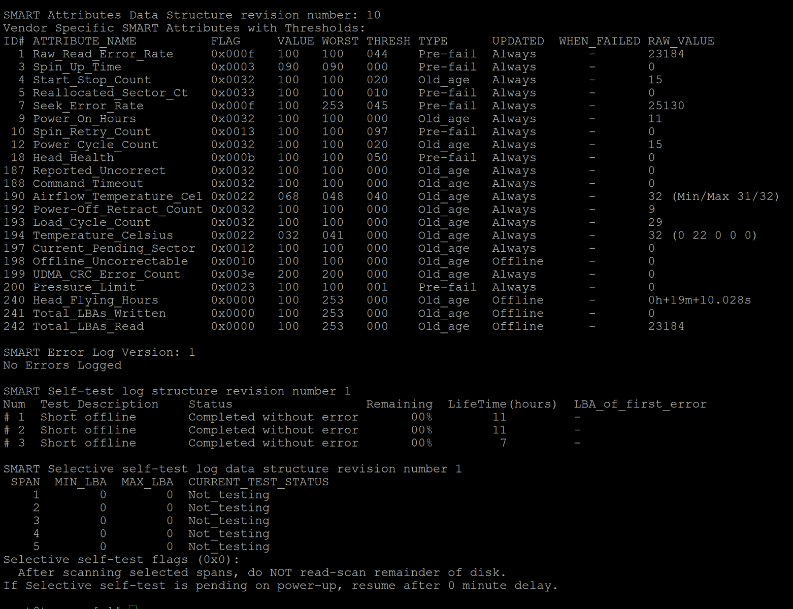

After my last issue with drives, I dismantled my Server and called it quits. However, that only lasted three weeks; I could not help myself and built another NAS. I purchased new drives, different models.
I was going to burn in the drives per the suggestions on the forum, and after assembling the system, I ran;
smartctl -t short /dev/sdg
To my surprise, all the drives appear to be dying. I bought them from NewEgg. Someone told me last time that the Raid controller could be an issue or the cables. After seeing the Error rate, I removed the LSI HBA controller and installed the drives straight on the motherboard with no controller. After the change, the Raw Read Error Rate continues to increase. All four new drives have the same behavior. Are they shot?

Ok, upon researching the forum, it appears that Seagate always has wonky Raw_Read_Error_Rate. So the drives are good.
9,700
The easy thing to do is compare the total LBAs Read (#242) with the Read errors (#1) and if they match, you're fine.
Seagate puts the total read together with the errors in a way that if there are zero errors, the overall value is the same as total read.
You can also give yourself a better view of it by modifying the smartctl command to elaborate those values properly...
smartctl -a -v 1,raw48:54 /dev/daX
See my post from a long time ago on this for more details:

Stretalla, thanks for the information. I am currently running the script to burn in the drives. It should be done running by tomorrow.
