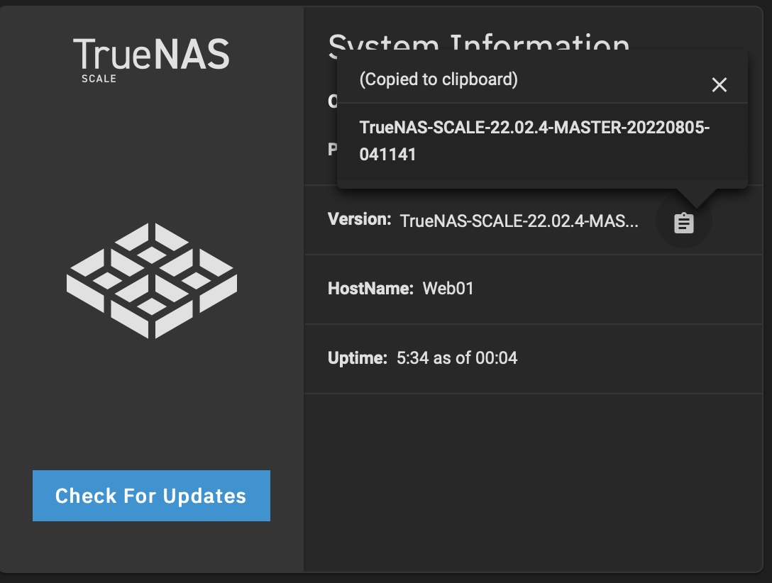

22.02.4 doesn't exist
GS059
Aug 13, 2022
4
then what am I on?
morganL
Captain Morgan
Administrator
Mar 10, 2018
2,694
then what am I on?
That's a nightly image?.. this can have bugs. Where did you get it?
The release version is 22.02.3
I think you should re-install or roll back.
