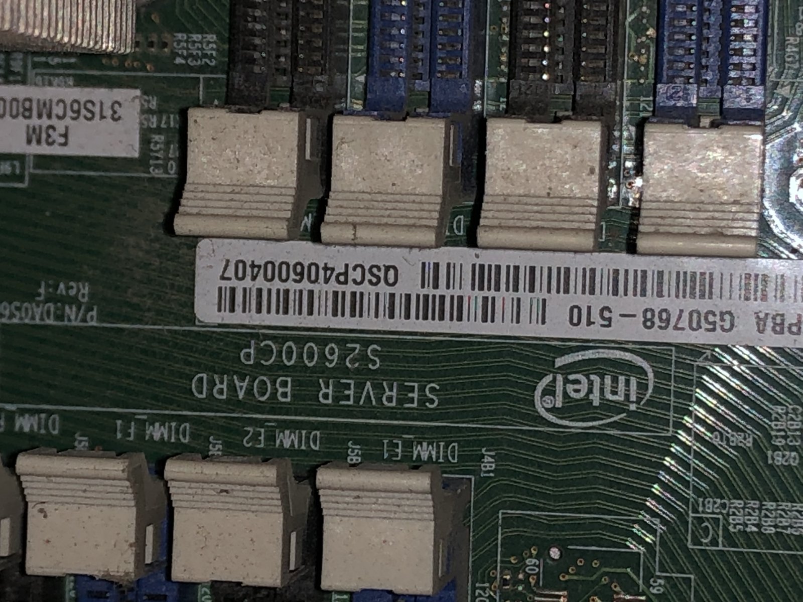

MB intel s2600cp

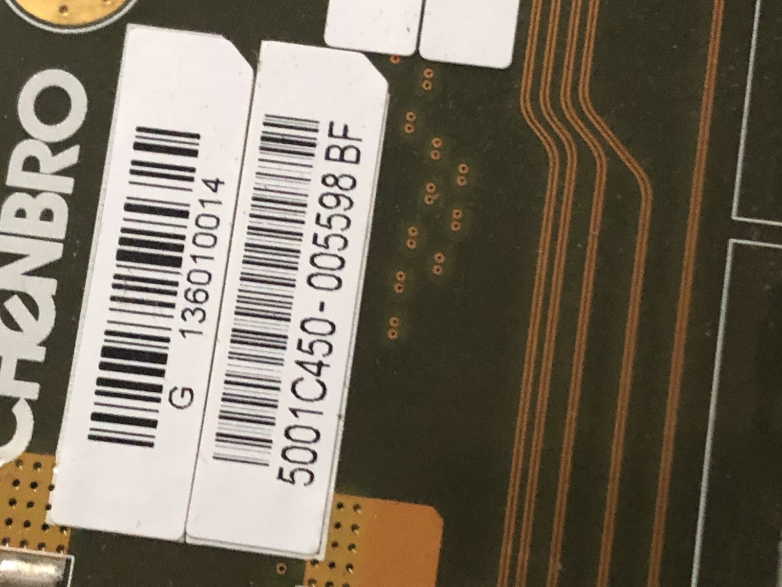

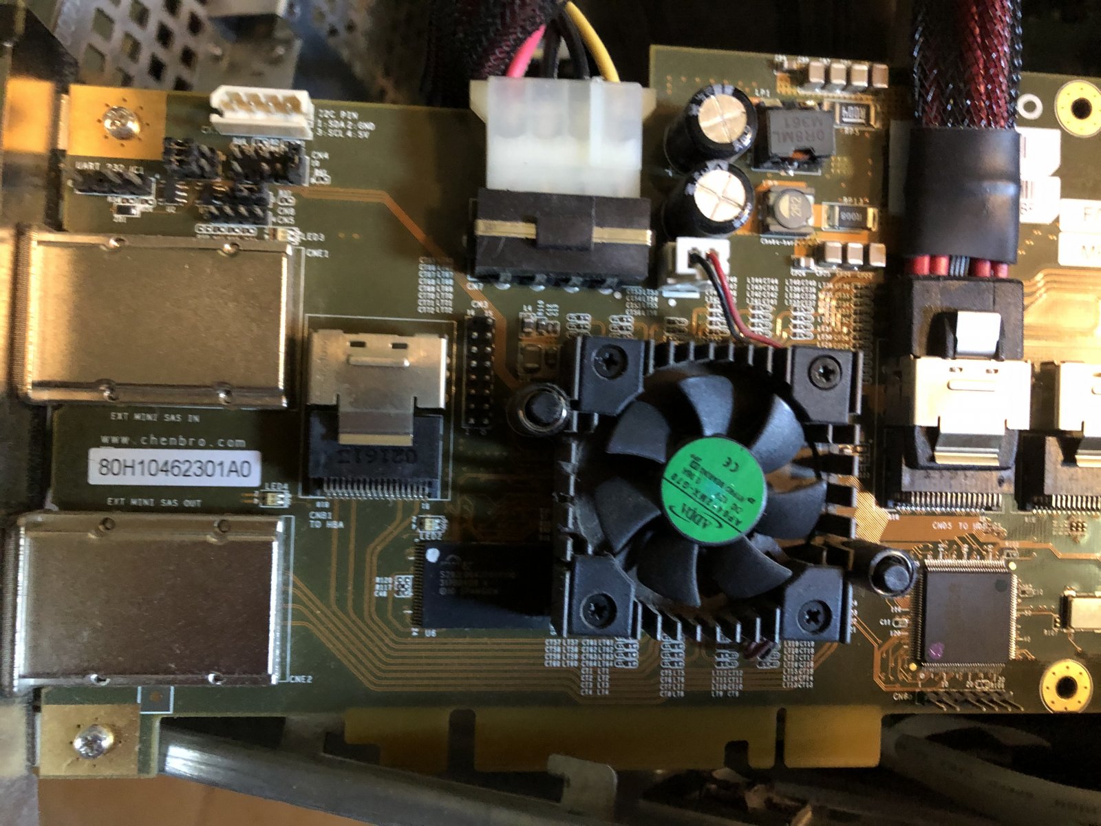

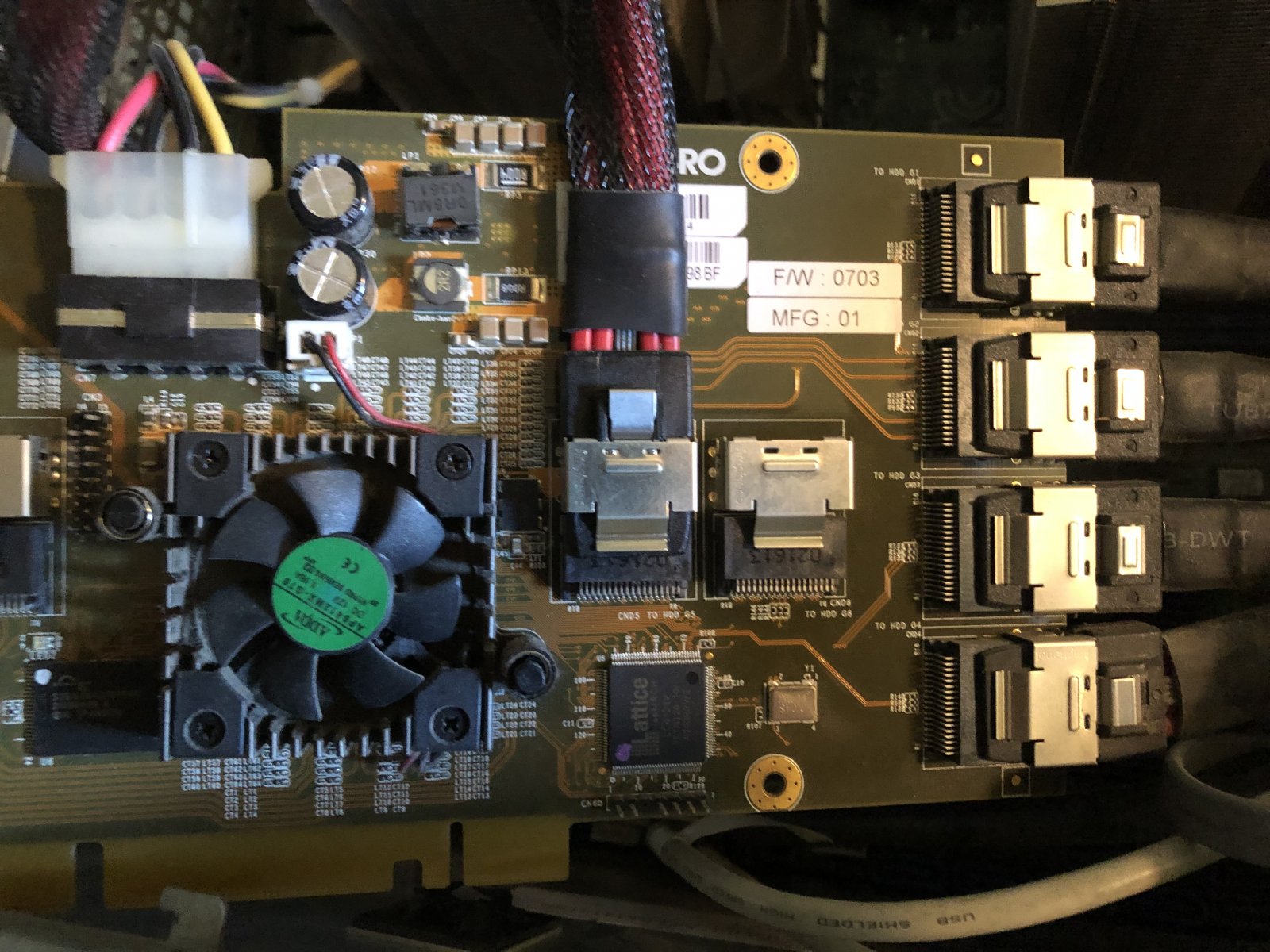

CARDS Chenbro (can not find model) sas/sata expander
(What I need to change) LSI 9260-8i

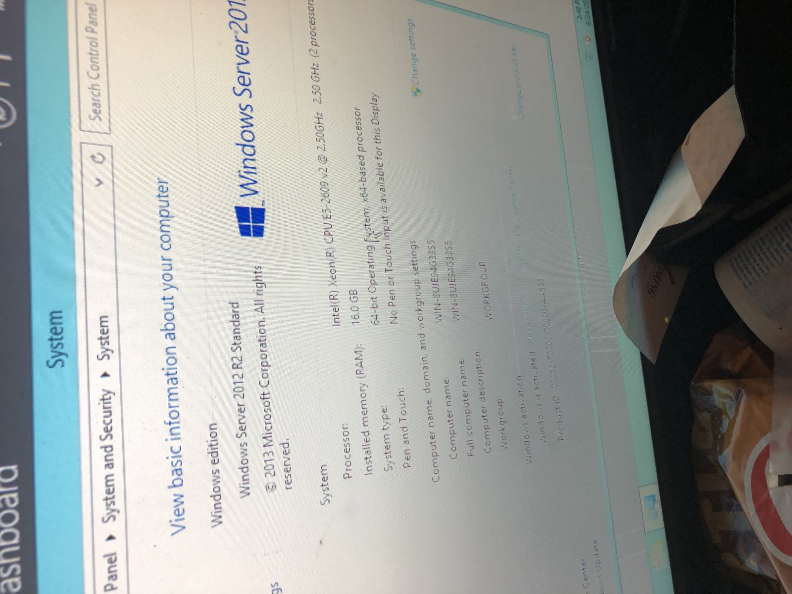

I hot this server blew the server 2012 software. Loaded trueNAS v13 (latest stable) on 250 fb Hd. Looks like the 2960 can not be put in IT Mode. I have been looking at getting an LSI 9211-8i and just connecting the cable from the expander to port 0 on the 9211 like the 9260 is currently. Funding conflicting information on weather the 9211 can do larger than 2tb and mad drives so say 12 others say 256. I am looking at some 25-70 dollar 9211-9i cards on eBay but don’t want to get one that will not work with my setup. Any and all help is welcome.

The 9211-8i and other cards based on the LSI SAS2008 chipset are perfectly capable of handling >2TB drives, and the expander should allow to you use more than the eight drives that can be directly connected.
The expander looks like the CHENBRO CK23601.

Your expander will allow for this, as SAS expanders behave in a manner similar to a network switch.
