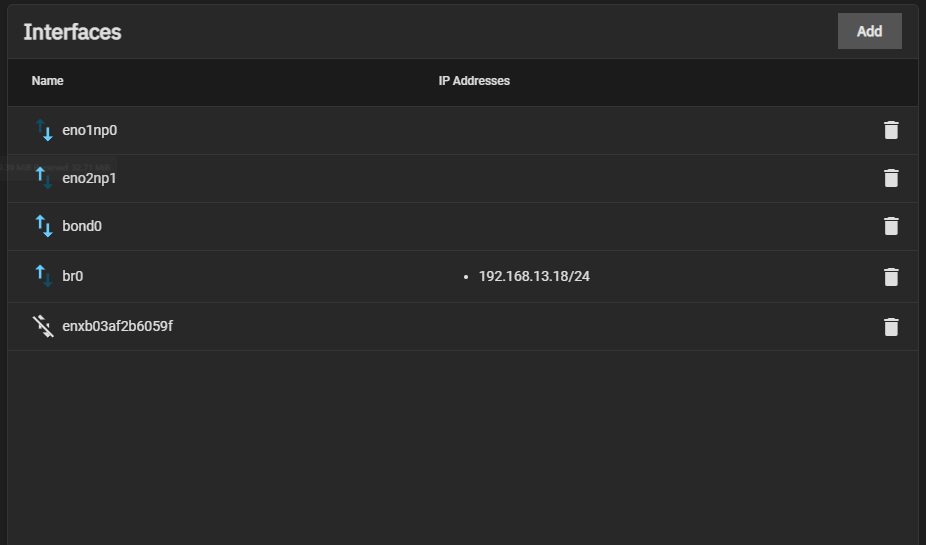

Regarding MTU - where exactly should I change this setting? As it stands on the TrueNAS side I have 2 connections showing the 2 ethernet ports, 1 bond (LACP) which aggregates the 2 and a bride of which the bond is a member of to make VMs work. The bride is the one that has the static IP fixed so should I change the MTU setting for all or just the bridge?

Attached a screenshot for clarity

You can change the MTU within Scale by clicking on the interface and updating the MTU to 9000. The bridge should be the one you need to change but it can't hurt to change them all. You will need to change the MTU on your PC and on the switch if it's managed. If it's not managed then it may or may not work.

Ha! Chris3773 and elvisimprsntr you are both stars! Thank you!
After changing the MTU setting on all 3 devices the speed is blasting at 10Gbps.
Writing this down for posterity should other noobs like me face this issue and find this thread:
  1. Changed MTU to 9000 in TrueNAS scale for the bride and bond (didn't test if both are needed)
  2. Changed MTU to 9000 in Windows using this guide from Microsoft
    1. In my case "Jumbo Frame" doesn't exist. I found "Jumbo Packet" and changed that to "9014 Bytes"
  3. Enabled Jumbo Frames on the Unifi Switch using this youtube guide
