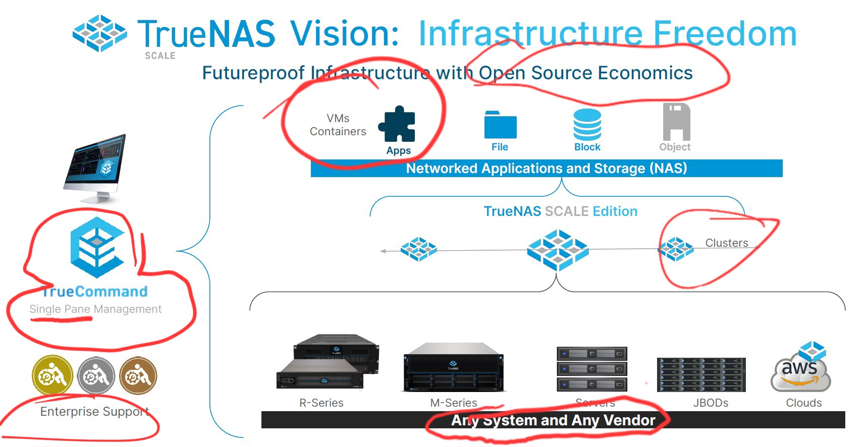

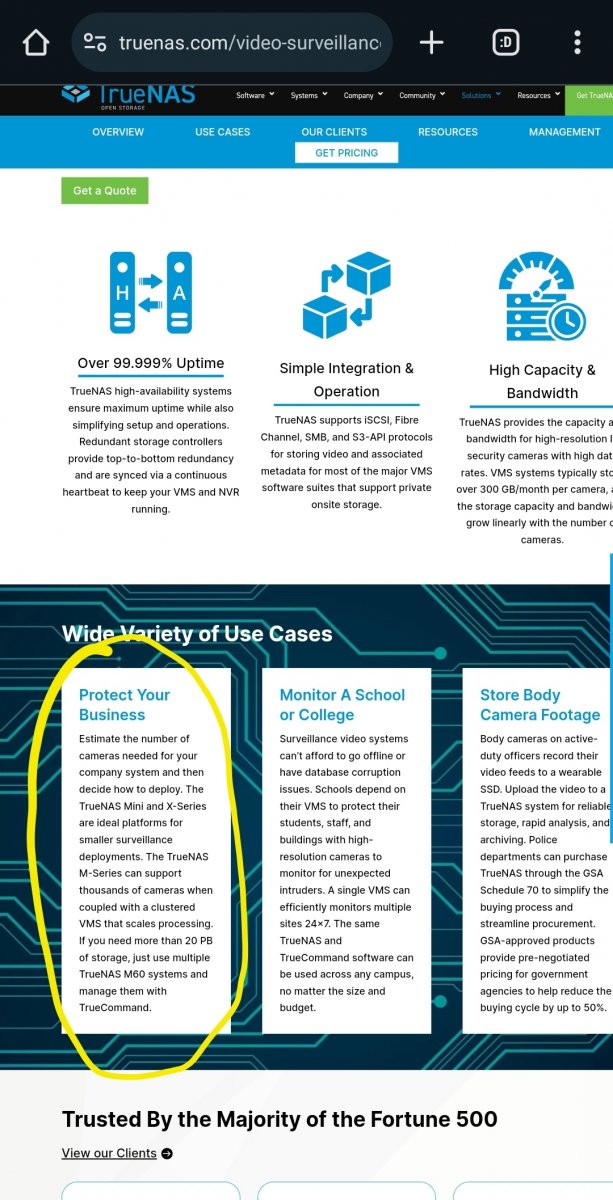

I guess I've misunderstood the marketing material. I also suppose that's why Trucharts is migrating away from Scale-first focus? https://truecharts.org/news/stability-tiers-and-helm/#google_vignette
Why are apps, especially using Kubernetes, part of the iX offerering if we cant actually create nodes across different systems?

Yea, that circled section isn't talking about K8s / Apps, completely unrelated. Lots of our customers in that example use-case would use an enterprise clustered virtualization solution for the compute (You can probably guess what the most common ones are) backed by TrueNAS for the storage component of those many incoming video feeds.
The TrueCharts bit is complicated.. In the end they have a set of goals that don't always align with what we are doing on the TrueNAS roadmap, which isn't too unexpected.

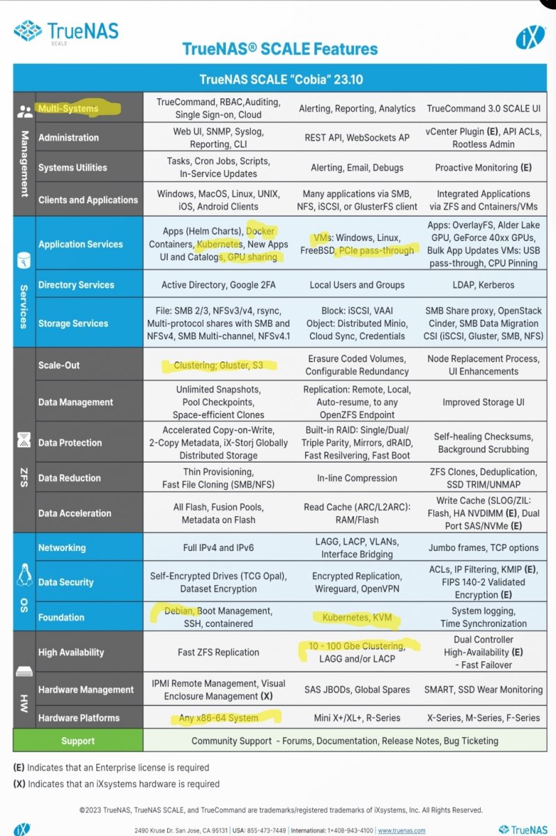

Maybe we're missing each other? Are you saying TrueNAS Scale is a great storage solution, but NOT meant to be a good platform for Kubernetes &/or VM's? I thought iX was transitioning to Linux & Kubenetes, using words like hyperconverge & scale to expand from JUST a strong storage solution to one that had the flexibility of Kubernetes/ VM's to manage computing loads across mutliple machines & hardware. Seems like there was much fanfare over "apps," especially the ones TrueCharts put a lot of energy into. However, due to conflicts with TrueCharts, it looks like iX has stepped back from emphasis on apps/kubernetes, which to me is disappointing.
I was hoping to find a software platform that I could put on all my machines, manage/scale both my computing & storage from one place, but it sounds like that is not what iX intends for Scale? Why bother with Kubernetes, VM's, PCI-E Passthrough, GPU sharing, "Single Pane Management," etc? What am I missing?

Just caught on to this thread. We are by no means backing away from Apps, if anything we're working hard on making sure the support for them gets better and smoother, with more options for people to run containerized or other workloads. We've even added some preliminary community level support for systemd-nspawn "sandboxes" in Dragonfish and you should expect you'll hear more noises on the container front before too long.
