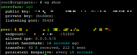

  • WG in the jail works so far:
  • In the jail I can ping the 10.5.0.2 internal WG interface an the 10.5.0.1 of the WG VPN provider server
  • A traceroute in the jail shows me, that the jail uses the wg tunnel.
  • I can ping the jail from my local network 192.168.8.48.

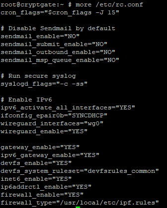

My Jail`s rc.conf:
cron_flags="$cron_flags -J 15"
# Disable Sendmail by default
sendmail_enable="NO"
sendmail_submit_enable="NO"
sendmail_outbound_enable="NO"
sendmail_msp_queue_enable="NO"
# Run secure syslog
syslogd_flags="-c -ss"
# Enable IPv6
ipv6_activate_all_interfaces="YES"
ifconfig_epair0b="SYNCDHCP"
wireguard_interfaces="wg0"
wireguard_enable="YES"
gateway_enable="YES"
ipv6_gateway_enable="YES"
devfs_enable="YES"
devfs_system_ruleset="devfsrules_common"
inet6_enable="YES"
ip6addrctl_enable="YES"
firewall_enable="YES"
firewall_type="/usr/local/etc/ipf.rules"
