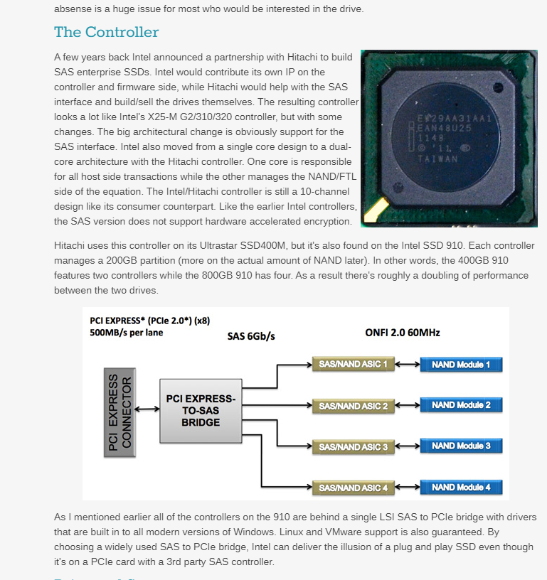

Hmm. There are similar flash devices from this period, some of them are in IR mode and some of them are in IT mode, but you aren't having that issue from what you are describing.
According to StorageReview at the time:
It absolutely is just a SAS2008, which is what is used in most HBA cards of that time period that are recommended for TrueNAS. I too think it would be interesting to see what lspci says?
