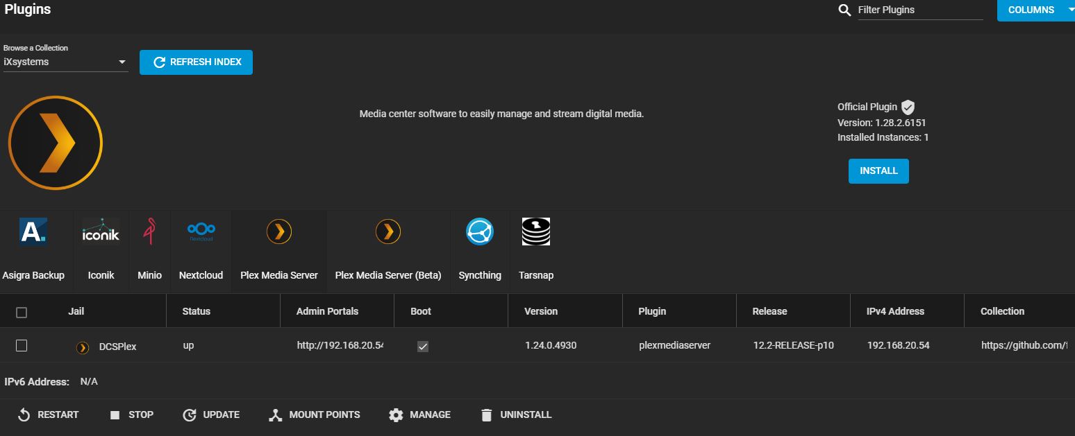

I'd like to proceed with also updating PlexMediaServer to the latest release.
I am currently running Ver 1.24.0.4930
Release 12.2-RELEASE-P10
The official Plugin appear to be @ 1.28.2.6151
How do upgrade from ver 1.24.0.49430 to the latest official support version on Core Ver 13.0-U2.
I've tried the Update option but appears to fail.

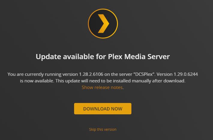

When I login to the plexmediaserver console from the LAN on a pc - Plex Media Server prompts with the following message.
"Update Available for Plex Media Server" You are currently running version 1.28.2.6106 on the server "DCSPlex". Version 1.29.0.6244 is now available. This update will need to be installed manually after download.
So I download the latest file... "PlexMediaServer-1.29.0.6244-819d3678c-FreeBSD-amd64.tar.bz2" approx 98,184 kb
Now I need instructions on how to manually copied it to the TrueNAS Jail to update the PlexMediaServer install to version : 1.29.0.6244.
Happy to perform a manual update if steps can be provided?

You need to look up the
iocage upgrade
command and update the jail version to 13 also. Once you do that you may have more success with the update.
Once you are on the same FreeBSD version in the jail as your TrueNAS version you can try the plug in update again or enter the jail shell and run pkg update after performing a service stop on the plexmediaserver.
