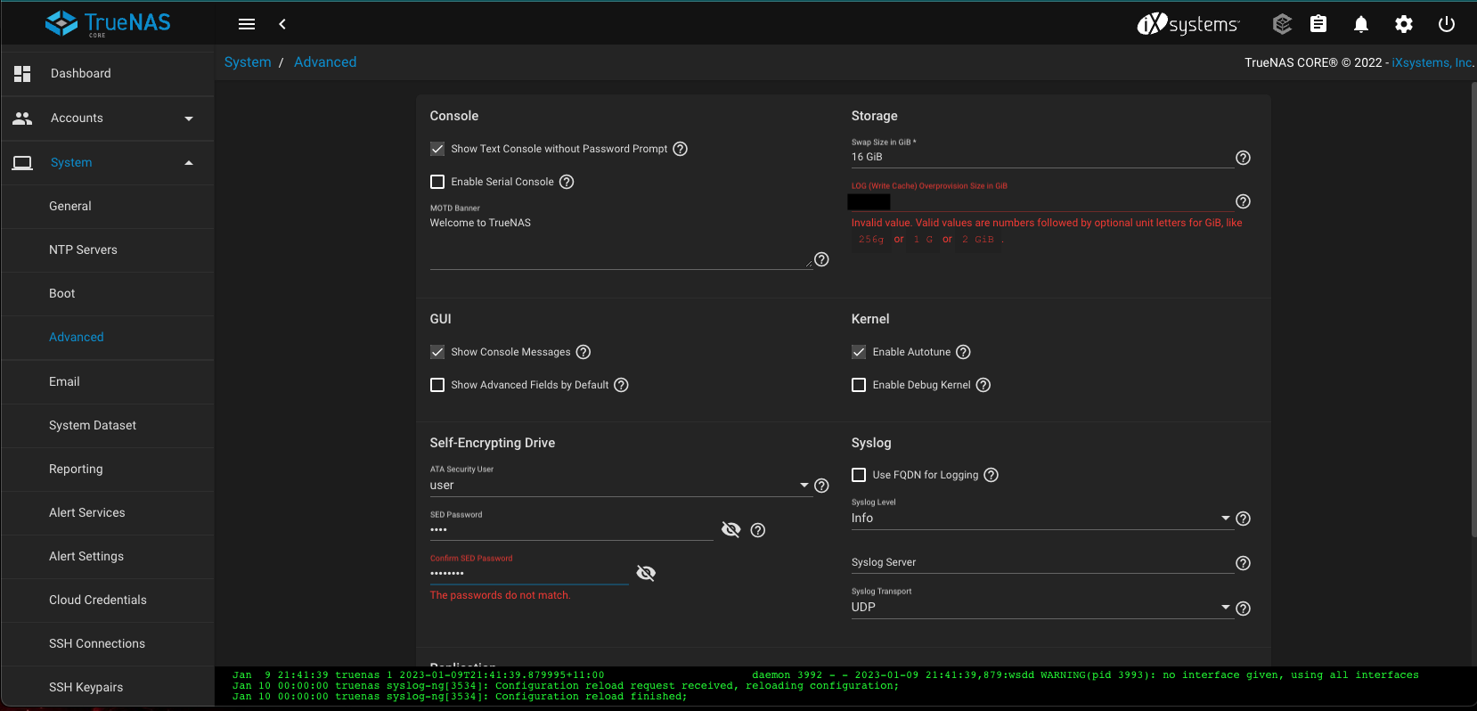

as well under system > advance i get auto complete errors relating storage and Self-Encrypting Drive. i tried to update the settings however every time i reboot it change back, see attached screenshot as well some command related to the Optane SLOG/L2ARC and Swap setup.

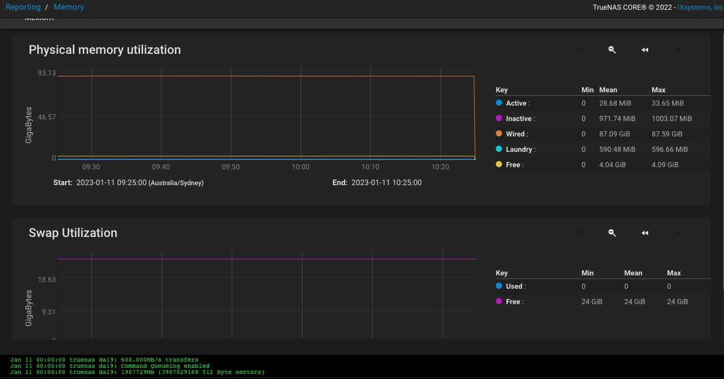

xxxxxx@truenas[~]# swapinfo
Device          1K-blocks     Used    Avail Capacity
/dev/mirror/swap0.eli   2097152        0  2097152     0%
/dev/mirror/swap1.eli   2097152        0  2097152     0%
/dev/mirror/swap2.eli   2097152        0  2097152     0%
/dev/mirror/swap3.eli   2097152        0  2097152     0%
/dev/gptid/6762c737-c0a1-11e8-9  16777216        0 16777216     0%
Total            25165824        0 25165824     0%
Looks like you use a password manager in your browser... you need to clear those entries or stop the autofill for that site in the password manager.
Thank you that worked i manage to save the settings

Thank you see summery printout, what do you think is the Optane SLOG/L2ARC and Swap working?

Thank for your insight,
Regarding ARC you mean i used all my memory capacity? i have total of 96GB ATM i'm running smb share and other basic ssh services no VMs or something special, what is a normal/recommended/Target ARC hit ratio? how do i find the issue and improve it?
L2ARC - So the Cashing is actually working from/using the Optane or different drive? i set the optane L2ARC to 20g, how do i find the issue and improve it?
what is recommended for both of the above?
attached hew screenshots
Thank you

No swap used is great. That's exactly what you want.
Using all your RAM is great too (most of that will be ARC... ZFS cache)
ARC hit ratio refers to how often something the system is asked to provide from disk can instead be provided from RAM (ARC). A high ratio is desirable/expected and yours is close to perfect (not surprising with a good amount of RAM).
L2ARC is on your NVME drive (from your pool status and glabel status above). As I said, it's not doing much (since you have plenty of RAM/ARC) with a hit ratio of under 10%... I would recommend to just remove it.
Other than removing the L2ARC, I see nothing that needs improvement (at least from what you shared so far).

Your choice. Removing L2ARC from a pool does nothing to the other items.
or you mean to keep the SLOG and SWAP on the Optane and use the 225G for another high speed use?
You could do that (keeping in mind it's not recommended to share a SLOG device for anything else).
if so what is my options or what you recommend using of the storage on the Optane?
Continue using it as SLOG (if you think you'll continue to need SLOG (VMs or block storage needing sync writes mostly)... but seriously consider your pool design if that's the case, since RAIDZ is a terrible choice for block storage: https://www.truenas.com/community/threads/the-path-to-success-for-block-storage.81165/
any good resource how to remove the L2ARC?
zpool remove Tank gptid/76d01ebd-c0a1-11e8-9f75-0cc47adb3218
9,700
Depending on how critical your VMs are, you could run them on the optane (and probably no longer need SLOG... and I would eliminate the Swap from it too), with replication (every few hours or every day, depending on how much you can afford to lose) to the RAIDZ pool cover for failure of the Optane
