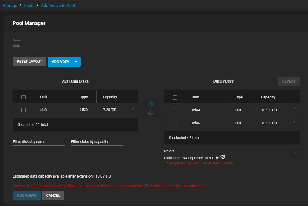

I have a pool with three drives set as raidz1. I want to add two more drives as a mirrored pair to the pool.
It appears that I can't do this through the web UI. There's a warning saying it needs three disks to make a raid-z vdev and no option to change what I'm adding to mirror.
I know there's supposed to be a performance penalty for mixing vdev types but for my use case, performance is not a concern.
What's the correct way to go about doing this?

The most important thing is to get a correct partition table on your new drives and strictly use the GPTIDs in the vdev setup, not the device names.
Please post the output of gpart show inside code tags and I can give you some command line statements that should achieve what you intend to set up.

What version are you running... that was an issue that was fixed a while back... you should be seeing a Force button to ignore the warning and proceed in the GUI.

I'm on TrueNAS-13.0-U3.1.
I wound up opening a shell and using the command: zpool add tank mirror <drive1> <drive2>
The change seems to persist between restarts so I appear to be good now. I was afraid it might not due to the appliance nature of TrueNAS.
