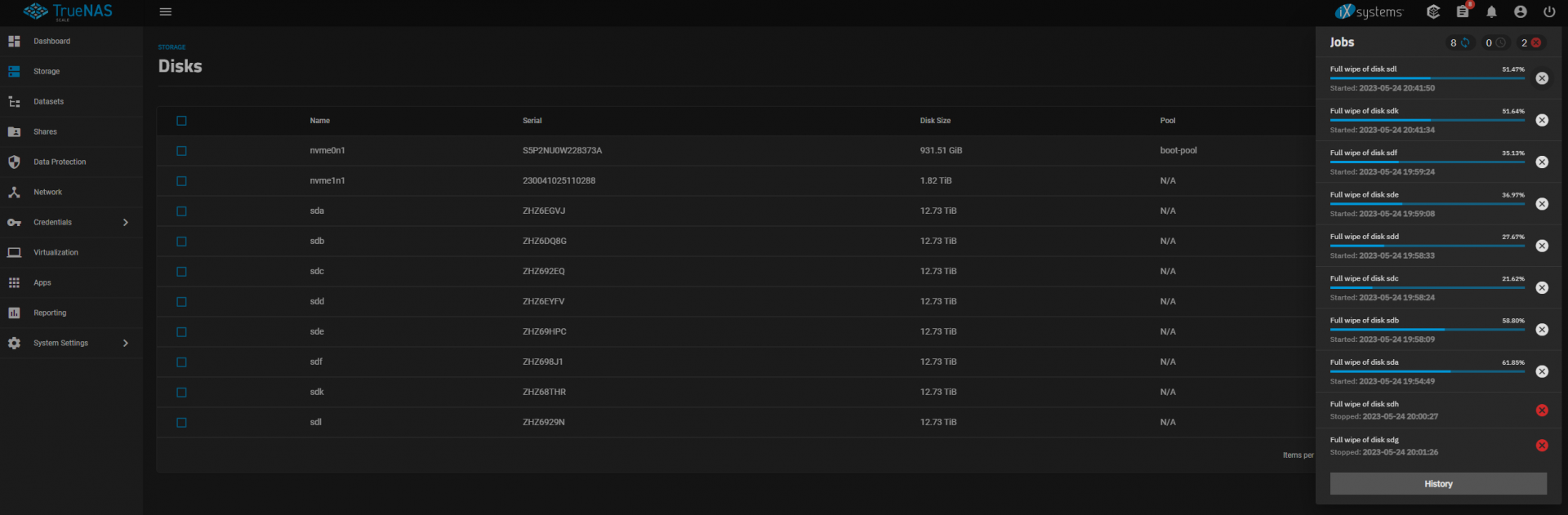

I am just getting into TrueNAS and this is my first implementation of it. I have 12 x 14TB drives installed.
When I installed TrueNAS from my flash drive and it asked what drive i'd like to install on, it showed all 12 of my hard drives plus my 2 m.2 drives.
When installed and booted in, I only saw 10 drives. I started wiping them back to zeroes and 2 drives errored out with this message and now I only see 8 disks.
"Error: [Errno 28] No space left on device"
That happened on disks sdg and sdh.
I also noticed my names on the drives skipped the 2 missing drives (like it recognized they were there but isn't listing them to add to a vdev).
Here is a pic for reference.
Can anyone help me discover what's going on?
Also for background, I had these drives in a previous install of TrueNAS that I ended up just wiping and installing fresh after some weird errors on all the new drives I got and TrueNAS taking 30+ minutes to boot up. This is all on new hardware, but the initial install of the OS was working flawlessly before weird stuff started happening.

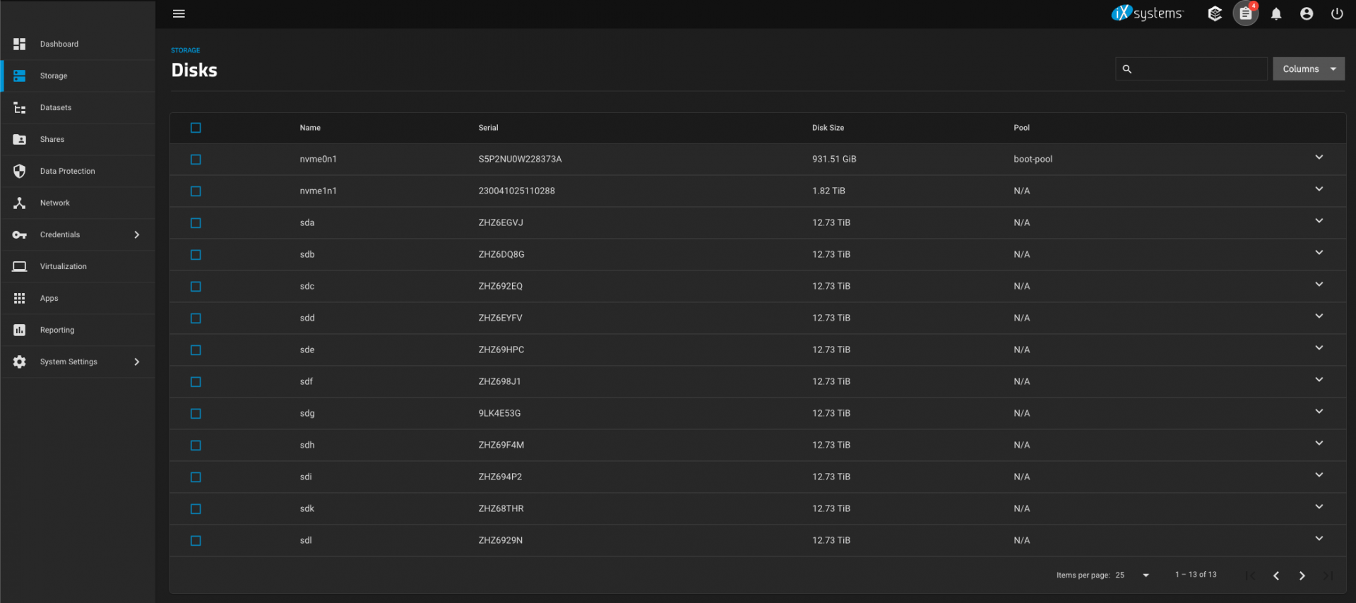

An updated screen shot, I'm assuming randomly sdj will pop up like the others did... but its weird...

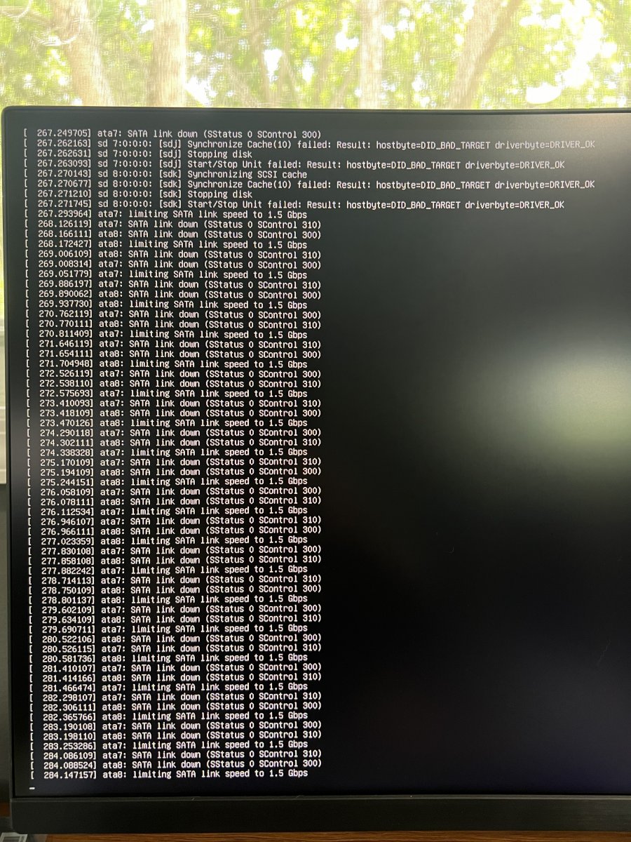

I did some testing and disks all seem good after burn in testing except 1, which is RMA'd and i'm awaiting on a replacement.
Things were running fine but i'm getting some errors on sata links going down which is what I think was causing those other issues.
I tried finding this error online but just found another post from months ago with no replies.
