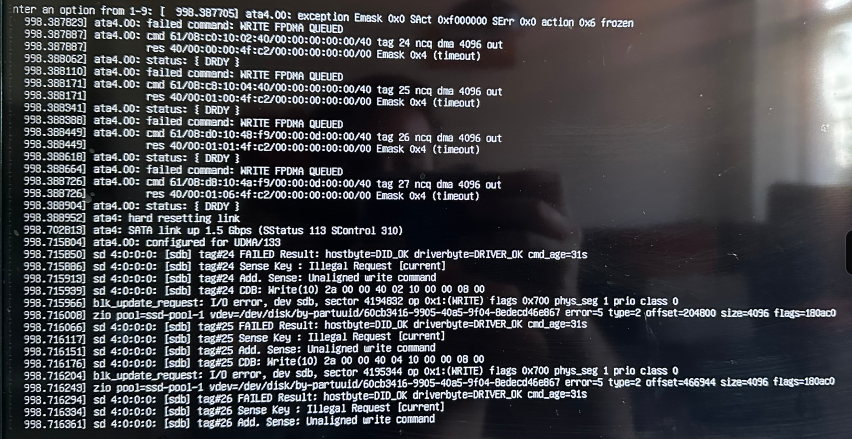

I got some progress here.
First I removed the H310 card since it does not look the problem is from it.
Connected the ssds again to the MB.
The change that I did was with the kernel settings, I have added libata.force=1.5G,noncq
24 hours of running together with smart test on every hour - all good so far.
After that just for the test I removed the setting and immediately one ssd failed a smart test.
One more note - I have tried libata.force=noncq or libata.force=1.5G alone, but getting the same errors.
What do you think is the hardware problem?
And just by adding the sata throttling would it solve the system stability?

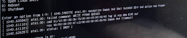

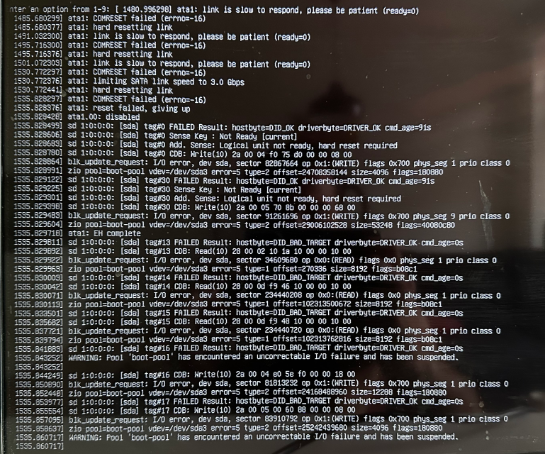

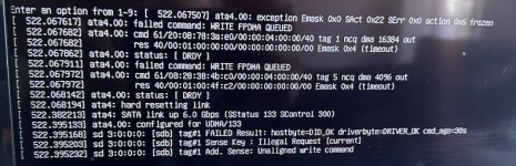

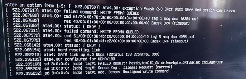

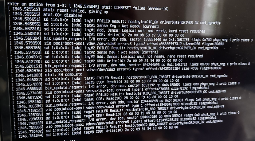

I have attached some of the error messages I see in the terminal.
Mainly:
  1. I/O error, dev sda
  2. WRITE FPDMA QUEUED
  3. Unaligned write command
