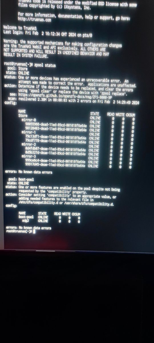

Two of the drives, which are a mirrored pair within the pool showed errors and when installed cause a boot loop. I have to remove both in order to get truenas to boot and allow me into the gui.
I then have to push them back in and import the pool as read-only.
I obviously then can't access the shares over the network.
Feb 2, 2024
8
The errors seem to be checksum errors. It is only showing errors on one drive in the image but it showed both before.
