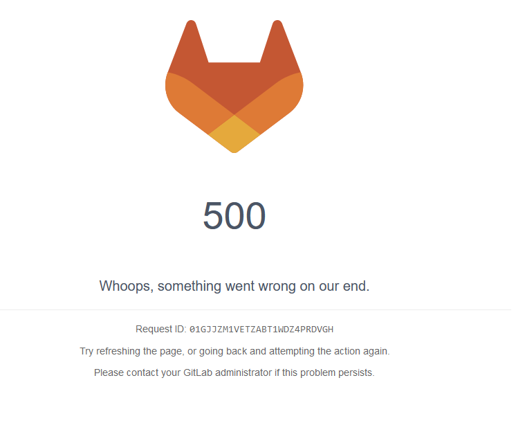

Gitlab 500 error after fresh installation
danny36
Nov 10, 2022
55
danny36
Nov 10, 2022
55
someone can help me? is this the best place to ask my problem or there is a plugin forum or site?
Patrick M. Hausen
Nov 25, 2013
7,776
The web server logfile inside the jail might provide some clues. I don't know which HTTP server the plugin uses, so you need to dig around a bit.

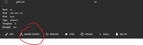

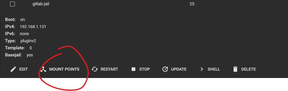

danny36
Nov 10, 2022
55
how can I see this log file? i'm not a linux expert. It's strange because in another installation gitlab plugin works.
I need to set the mount point?
Patrick M. Hausen
Nov 25, 2013
7,776
You need to ssh into the jail, use ps on the command line or pkg info or look at /etc/rc.conf ... to find which web server is running, then search beneath /var/log for whatever is configured as the log file.

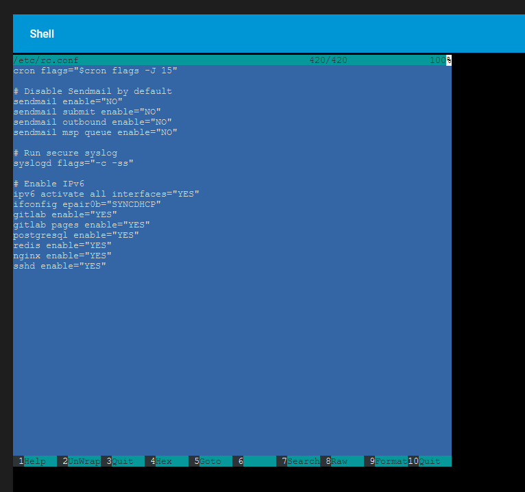

danny36
Nov 10, 2022
55
this is the /etc/rc.conf file
Patrick M. Hausen
Nov 25, 2013
7,776
So the web server is nginx. There should be log files in /var/log/nginx.

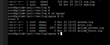

danny36
Nov 10, 2022
55
I'm sorry but i cannot to copy/paste from ssh from firefox browser, anyway the error log of ngix it's empty
Patrick M. Hausen
Nov 25, 2013
7,776
Don't use the shell in the browser. Use an SSH client. That's the point. The browser shell is broken.

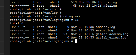

ok thank you patrick, now I can log into ssh and into the jail but nothing error in the ngix log file.
I have set a static ip address for the gitlab jail and now I get a 502 error message (Whoops, GitLab is taking too much time to respond.) on broser but no error in log file.
Patrick M. Hausen
Nov 25, 2013
7,776
You need to check the nginx configuration for other logfiles locations. This whole thing is configurable ...
Also possibly it is not nginx but some gitlab builtin web server that generates the error. Check the gitlab configuration. All configuration is probably somewhere under /usr/local/etc
