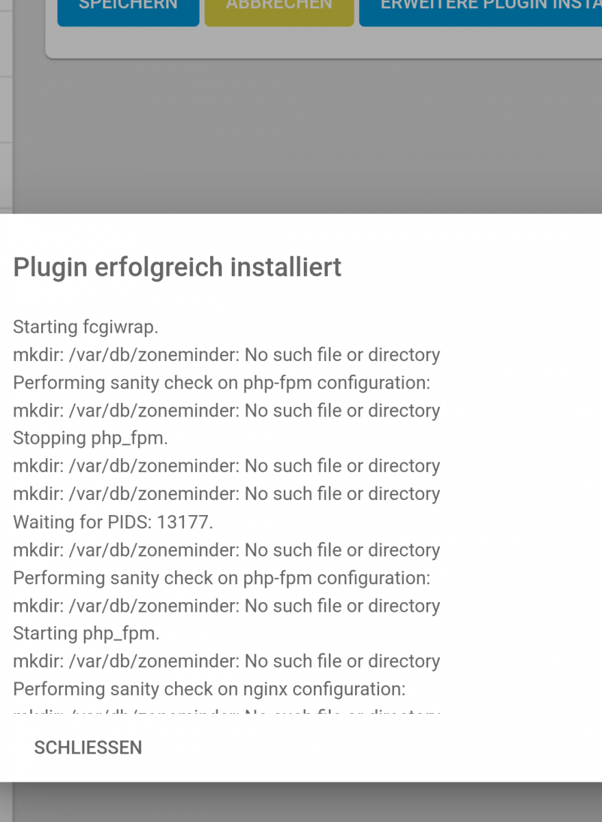

I'm on the lastest stable build of truenas core, I installed several times the zoneminder plugin now and everytime I try to open it it gives me the 404 error.

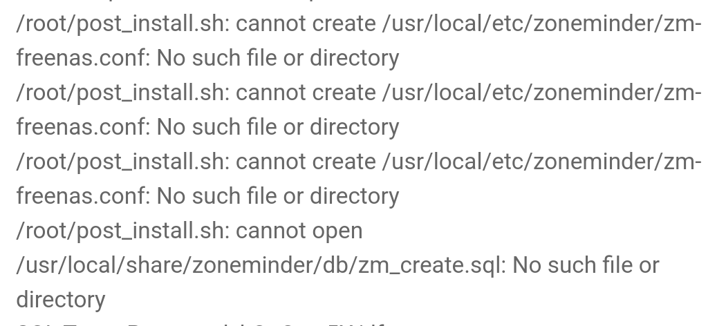

After the install the log said all installed, I just saw that on the log bottom it says no such file or direction. That's the only thing I found and I can't explain.
Is their a issue with the plugin and truenas atm or what could be the problem?
I attache a pic so people can see what I mean with no such file or direction.
"Plugin erfolgreich installiert" means plugin successful installed

So, plug-ins as a system are being removed in 2025, and aren’t being maintained. There are some alternatives.
You could switch to Scale, which has zoneminder as an app.
Or you could create your own jail and install zoneminder according to the documentation here. https://www.freshports.org/multimedia/zoneminder/
This is as simple as pkg install zoneminder but the db server and web server will also have to be configured.
All the instructions to do so are in the link I shared above.
